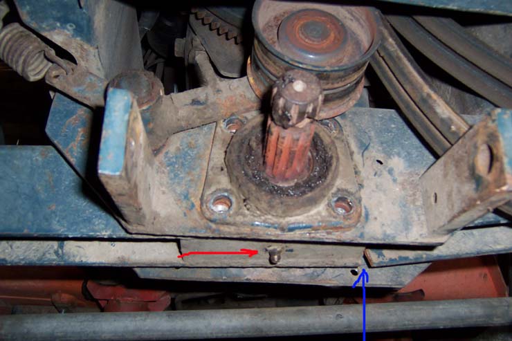

Well I got a feeble start today on pulling the front axle out of my Kubota. Unfortunately I think it is going to take some work as the front axle pivot lube was neglected for so long it is almost welded to the frame. If I stand on one end of the axle with my 225 lbs the axle will only move if I bounce up and down a bit. It is possible that the lack of lube may have contributed to the axle break. As it turns out the axle is cracking on the front side as well (blue arrow).

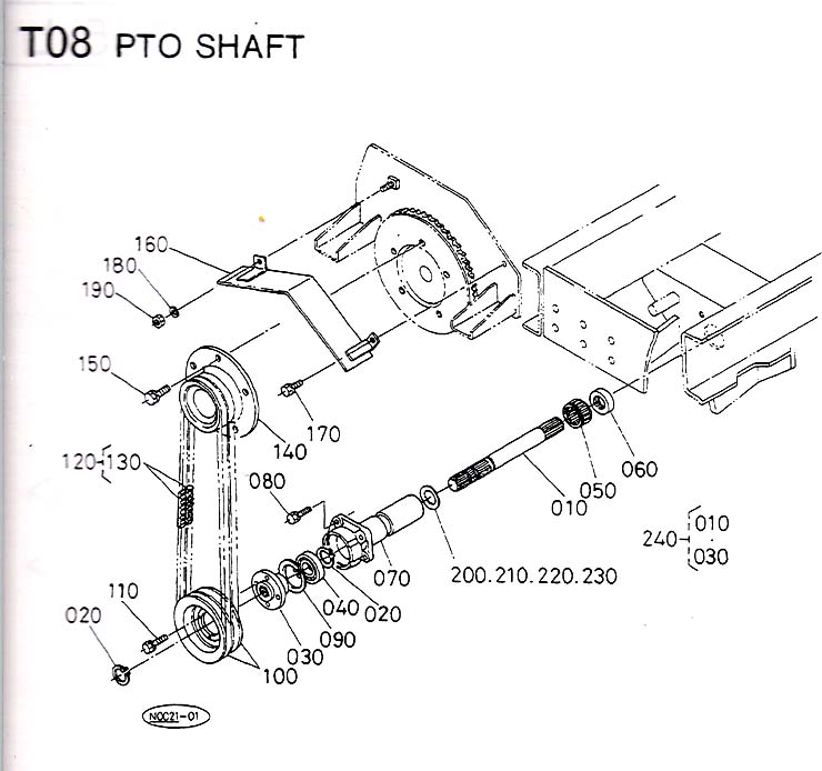

I tried pumping grease in the zerk and got little to go in indicating that the grease in the "Axle pivot is caked solid." I am yet to remove the pto shaft as I can't find my large "c" clip tool to remove item 090. Will buy one tomorrow. I believe the axle support #070 is supposed to slip out the front along with PTO shaft after removal of the 4 cap screws 080 but gentle persuasion has not budged it. I do not want to apply heat but was wondering if I removed the zerk and injected JB blaster if it might work to loosen things up. what do you think?

"injected JB blaster" I guess it would be worth a try, soak for a week maybe? With my luck it would be spray, heat, hammer all the way!

They make injector tools to shoot penetrant into grease fittings. Kinda pricey, but so is spending days removing frozen fittings.
http://cgi.ebay.com/ebaymotors/Grease-Joint-Rejuvenator-Unplug-Cleaner-Buster-Fitting_W0QQcmdZViewItemQQ_trksidZp3286Q2em20Q2el1116QQitemZ280223154640QQptZMotorsQ5fAutomotiveQ5fTools
I've done kind of the same thing with a std grease gun. I pour penetrant into the grease gun, then pump into trash can till the penetrant starts coming out. Has worked many time for me when grease wouldn't think of going through.

I guess I am right to assume the only thing holding this support in is supposed to be the 4 cap screws I removed.
I guess that only thing holding this thing together is the is the rust and grime which I have been soaking and tapping with a drilling hammer. In fear of damaging the end of the "pin" I decided to stop pounding on it. today I rigged up a puller with 1/2" all thread using oak and a crossbar of Peruvian alder. I thghtened it down and was pleased to see the gap open (red arrow) but furthered noticed that the gap between the frame and axle (green arrow) had closed. Rats all I was doing was bending the frame.
I put some washers between the frame and the axle to prevent the frame from moving. I then proceeded to retighten and heard a loud pop. I was pleased thinking I had broken the pen loose but it turned out that it was just my Peruvian Alder cracking. I added another piece of red oak over the top and tightened it as much as I could, but nothing is giving.
I decided I would leave the pressure on and soak it again with JB Blaster. I fear I may damage the frame. Should I try my impact wrench? I do think I need to try finding a small bottle of penetrating oil and do the trick with the grease gun Daniel suggested. Hard to find anything but aerosols.

I'd say rust at the rear is all that's holding it. I'd put a lot of pressure on your puller, then heat the rear plate with oxy/acet torch. I'd bet she'd come free with ample heat.

Done have oxy/acet, suppose propane torch with MAPP gas would work? I'm just concerned about the seal and bearing at the rear.
Posted - 02/11/2009 :  16:24:12  Show Profile  Visit olcowhand's Homepage Send olcowhand a Private Message  Reply with Quote
I suppose that might get hot enough, but that seal will likely be destroyed either way. The bearing should come out fine, but will need cleaning. Can you pry the seal out?
I suppose I should just count it lost... It did not look particularly good to begin with. I suppose the local dealer can provide one.
