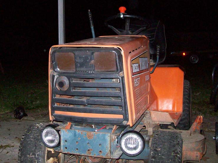

I was out sweeping leaves this morning on my Kubota. Typically the tractor has a very tight turning radius but this morning I noticed that the tractor only turned about half as tight turning left as it used to and when I turned right it seemed to turn tighter than ever. I thought it might have a sheared pin or a bent drag link but I got off and examined the steering and found everything in order. I was still pondering the problem as I continued to sweep up the last of the leaves I had mulched when I looked down and noticed that the left hand axle end was out of position about an inch further forward than it was supposed to be. Rats! It turns out that I have a broken axle. The axle assembly is a deep inverted channel with a huge center tube. The rear flange of the channel cracked just to the left of the pivot tube.
The tube accepts a hollow center pin which contains the front PTO shaft. (I believe that is similar to the Sunstar setup) It appears that there is enough clearance on the frame to allow a scab to be welded on the back of the channel to reinforce the axle. The exploded drawings of the parts manual make it look like the disassembly is simple but you never can tell. Don't know yet if the PTO shaft has to be removed first or if it will come out with the pivot pin. I fear it might be like everything else on the tractor (not easy to work on even if you can see what you are doing. I removed the mower (a 30 minute job) and parked it in the shed until time is available to dig into it.
