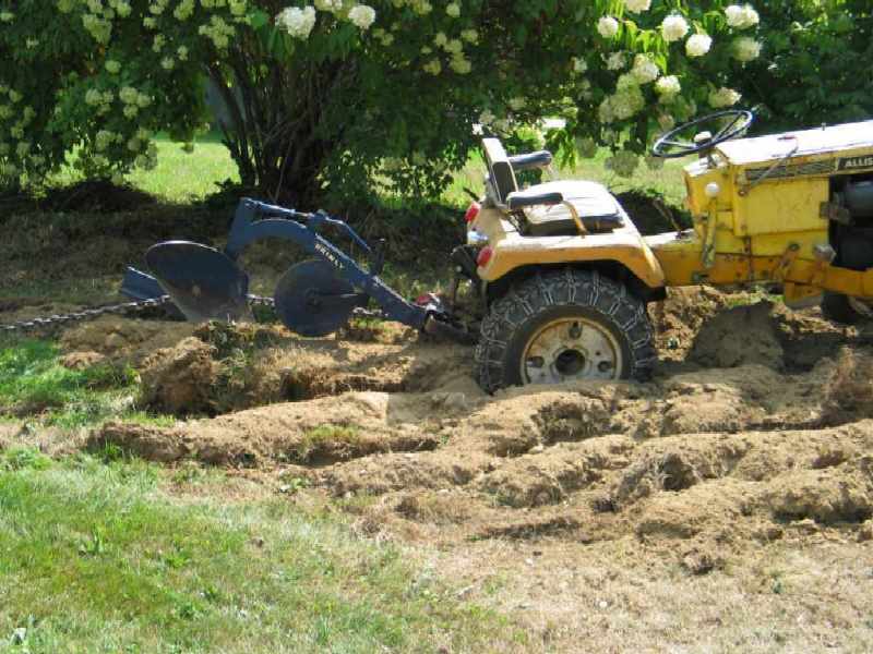

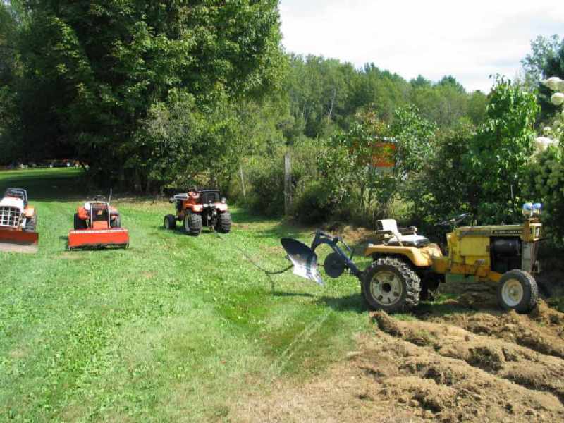

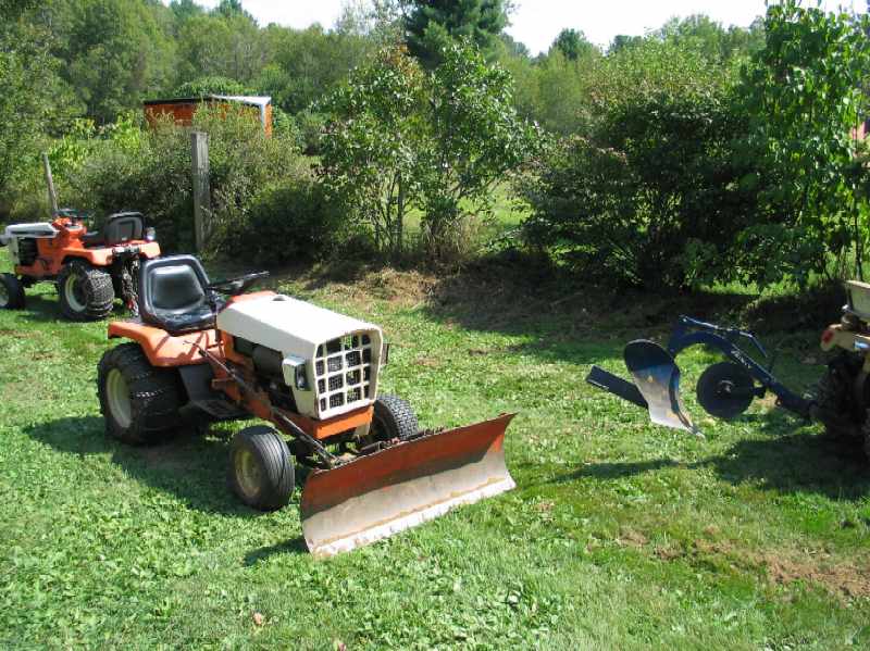

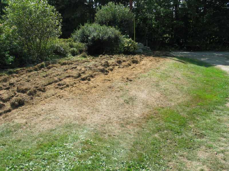

Redoing a bad spot in my lawn where the sun always cooks it, and removing an old fence while I'm there.
I used:
3416H puller to pull out fence, and then the B-210 when I got it stuck..
3212H Weedcutter to clean up around bushes
3416H Dozer to start leveling/grading

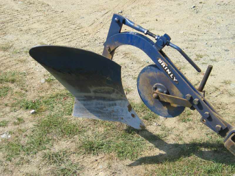

B-210 with 10" Brinley Moldboard
And a 3415S with cart to pick rocks.
Now I got to go mow with the other 3212H. :)

40 or 50 years ago you would have made an excellent sales brochure for Simplicity. Have fun.

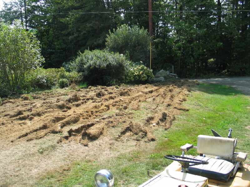

Wow, those look like very deep furrows. How deep are you plowing?
Posted - 09/08/2012 :  04:35:13  Show Profile  Visit larry8200's Homepage Send larry8200 a Private Message  Reply with Quote
I think about six inches. I would go deeper but I like plowing in 2nd, and its as deep as the B-210 will pull it without going to 1rst.
Actually, I'm just breaking up the sod before roto-tilling, and a ripper bar would be as good or better, maybe, and would pull much easier. I pronbably wouldn't bring as many rocks to the surface though.

Plowing in rocks, careful you don't break your coulter. I understand that they recommend removing the coulter when you are turning rocks. Of course it will rip the sod pretty badly rather than cut it. Is it true that rocks work their way to the surface each year as a result of the frost. This is all foreign to me as we don't have rocks and have a frost line of 2 inches.

I have my coulter set all the way up. With this anemic sod I'm turning up it doesn't seem to make much difference.

Daniel, I thought there was to little topsoil but it looks like the soil is depleted there and just wont support thick turf that can withstand the summer sun. I am going to grade it out so its easier to mow, add some "nutrients" and re seed in October.

In this case I think the B stands for Beast! Be careful, that B may bury itself. Gotta love the torque.
