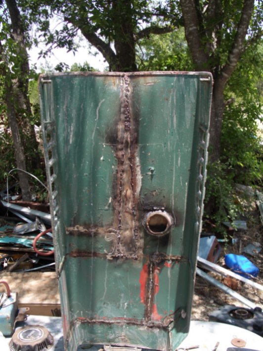

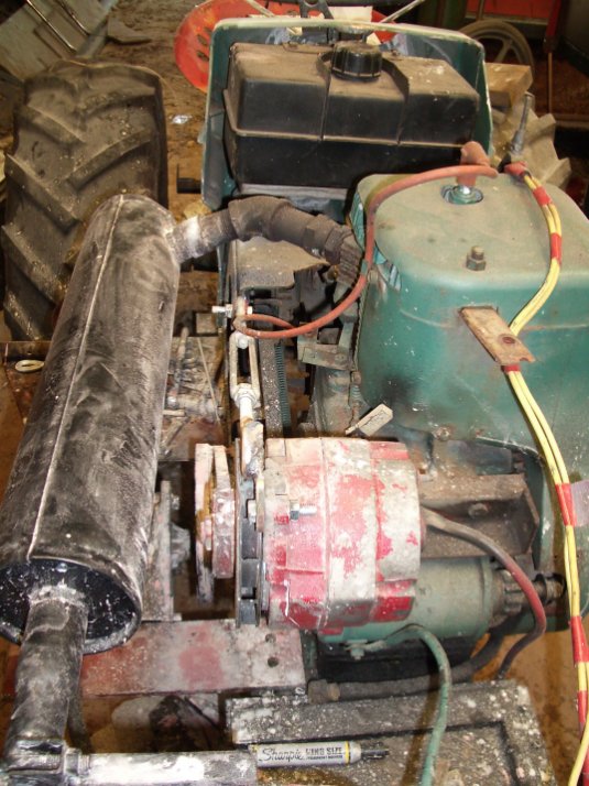

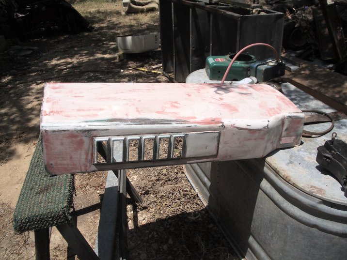

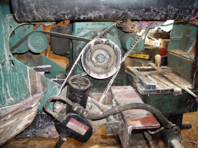

Got around to welding in gaps in hood and smoothing out the outer surface for paint. Also added Chevete pulley to original to power an alternator and ford power steering pump for hydraulics.
Giddy up Go from the little state of Texas.

Does the long muffler cut down on the engine noise? I like your hydraulic setup.
Stan
cleatusj
134 Posts
Posted - 07/16/2009 :  19:09:26  Show Profile  Visit cleatusj's Homepage Send cleatusj a Private Message  Reply with Quote
There is no exhaust note to be heard above the Wisconsin AENL. By the way that is an Onan RV generator muffler.
