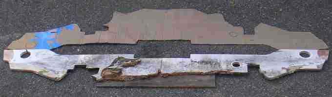

Posted - 06/06/2009 :  14:22:22  Show Profile  Visit B112's Homepage Send B112 a Private Message  Reply with Quote
Ok, spent the last few hours making this template for the rear bulkhead:
Next is the 1/4" plywood template...
Michael
