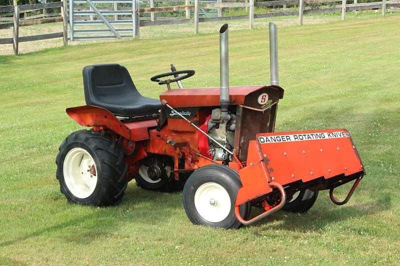

You still have the muffler under the hood though. How about exhaust wrap? I use this stuff on the headers of my tuner cars.

BTW, those dual stacks make yours look sinister!!! :)
I have removable baffles in the pipes, to keep friendly with the neighbors.

Just curious as to shy the weed cutter has a full loop slider on the right side, but only a teardrop shaped slider on it's left? I'm assuming it throws the cut stuff to the left & the tearrdrop shape lets it pass over it easier?
Posted - 06/30/2012 :  19:38:00  Show Profile  Visit 1014211's Homepage Send 1014211 a Private Message  Reply with Quote
It all goes left, Daniel. I never thought of it but I bet thats why.

Posted - 06/30/2012 :  19:51:52  Show Profile Send Count Macula a Private Message  Reply with Quote
Daniel, I never really thought about it either but I think you are correct. With my experince the cutter doesn't really throw the cuttings very far, unless I hit a downed branch then watch out splinters are going everywhere! It more lays the stuff down and chops it up, so if there were a full loop in the left it would probably get bound up.
It truly is awesome though, I have cut fields of grass taller than the stacks are high.

Originally posted by Count Macula
I bet a muffler stack would fix your heat issue. And seriously, besides a weedcutter, whats cooler than a stack?
It was supposed to act like a plow,, the front is angled,, but not quite enough,,, they had good intensions when they designed it though.
