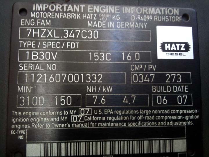

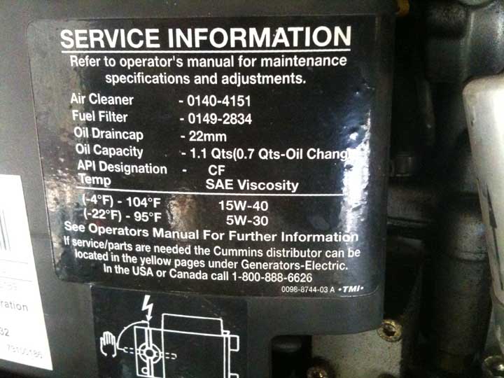

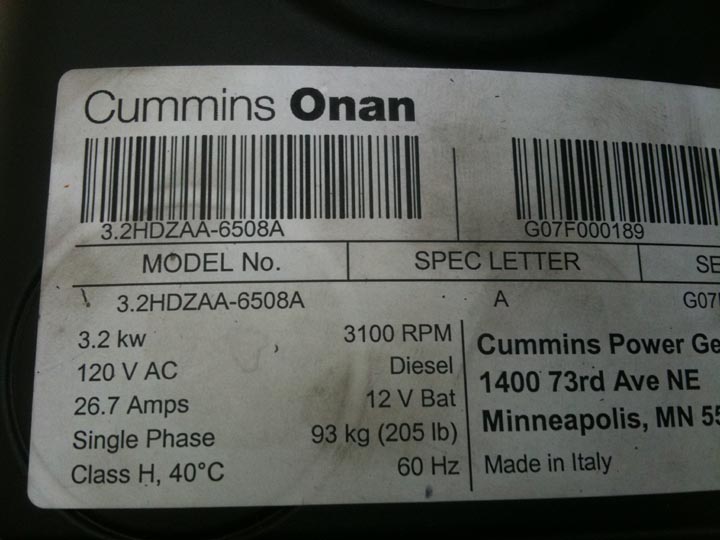

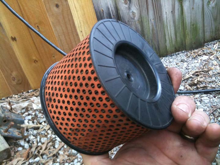

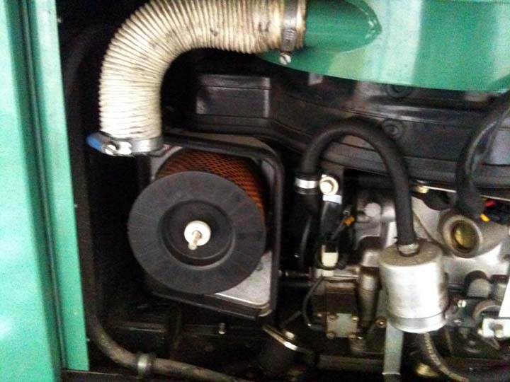

I have been a little concerned that my Genset on my RV is smoking too much. It is black smoke, not heavy but you can see it. The heads over on the RV site say it should not smoke at all. Well I thought the usual suspect would be a dirty air filter so I took her out and checked it and it did not look especially dirty but I thought I would just order up a new one and change it.
I went on line looking with no success at all locating a filter.
It is a Hatz filter #0140-4151. I could go to my local Onan dealer but I really don't have the time to go when they are open.
Anyone have any suggestions? The generator only has 127hr on the clock.

No cross to that anywhere! Here's a place to order it from:
http://www.rv-supercenter.com/product_p/tr556931.htm

I finally got my filters and installed a new one. I was a bit skeptical as the old filter only had about 137 hours on it and did not look to be restricted at all. Well, it must have done the trick because I ran the generator yesterday for the first time since I changed it and it operated for two hours with almost no perceptible smoke and little odor. Thanks for the help guys!
