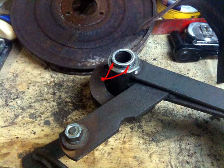

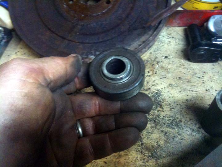

I did not get to the tiller but I managed to get started on the frozen up mule drove. I quickly found that someone had applied a heavyt hammer to the pulley sleeve assembly #105166 and had turned the end over into a mushroom preventing its removal from the idler lever assembly #105177 .
After much filing, grinding and sanding I manager to remove the displaced metal and finally get the assembly apart. If you are afraid to get your hands dirty than you are probably involved in the wrong hobby.
