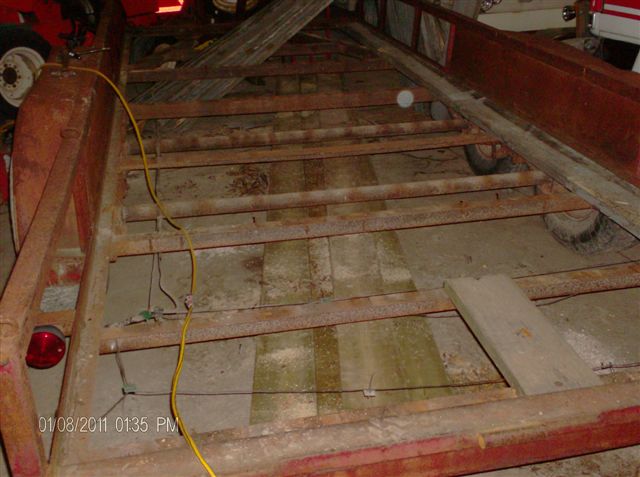

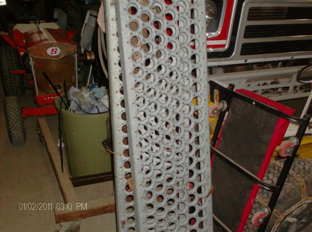

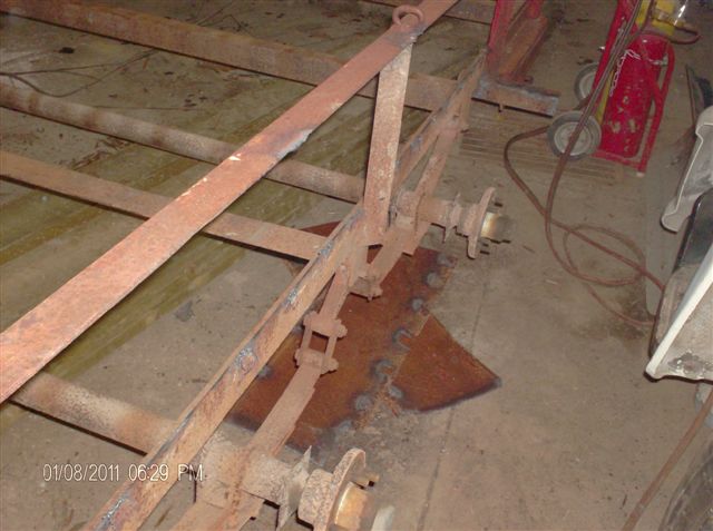

Moved stuff in the shop yesterday and put some in my new storage building. This gives me just enough room to get my trailer in for a rebuild before going to the GOTO in Florida in February. I will be redecking it, straightening one top rail, replacing the fenders and splash plates, changing the rampgate to stowable ramps (to lower towing air resistance), replacing tongue jack and hopefully a paint job. Here are the before pics and I will post more as the job progresses. Dave.

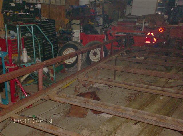

Posted - 01/08/2011 :  22:06:46  Show Profile Send B10Dave a Private Message  Reply with Quote

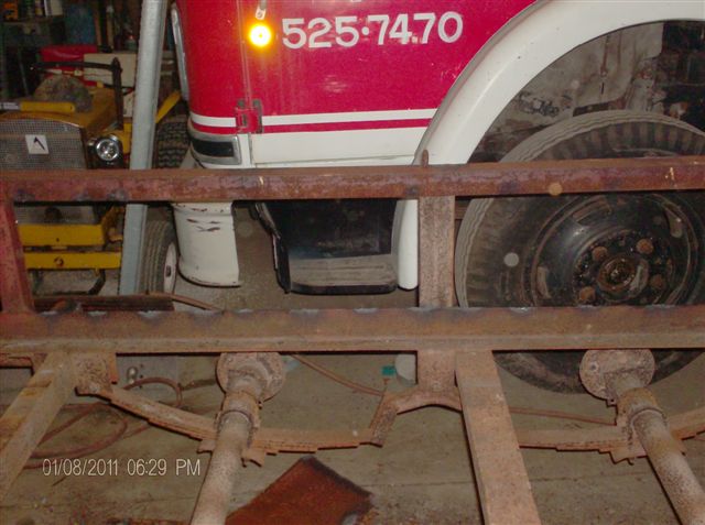

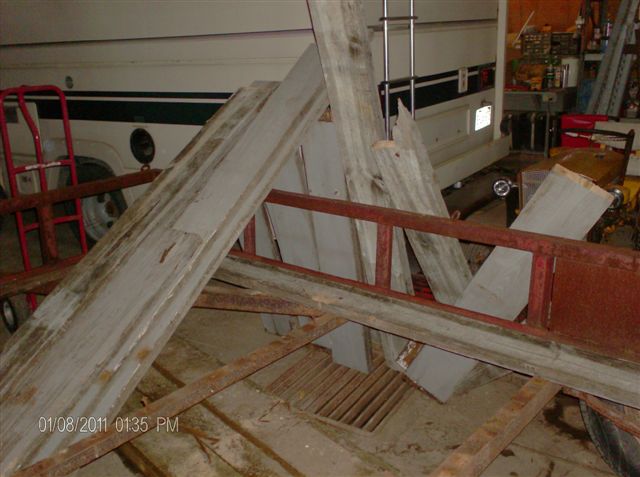

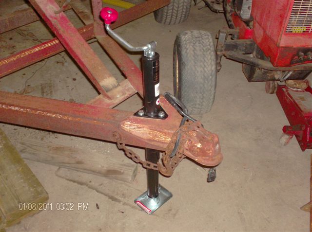

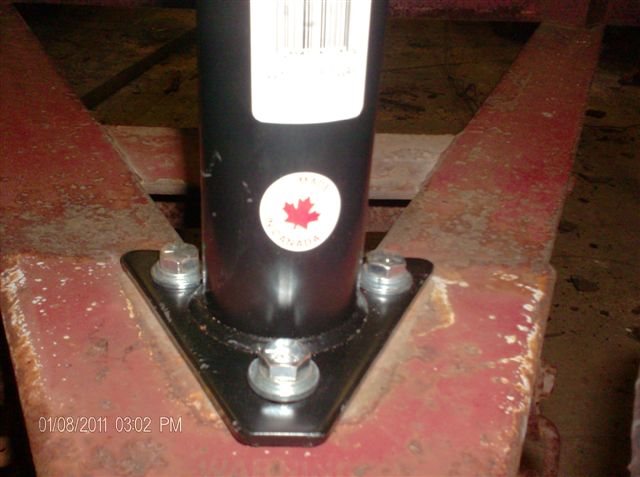

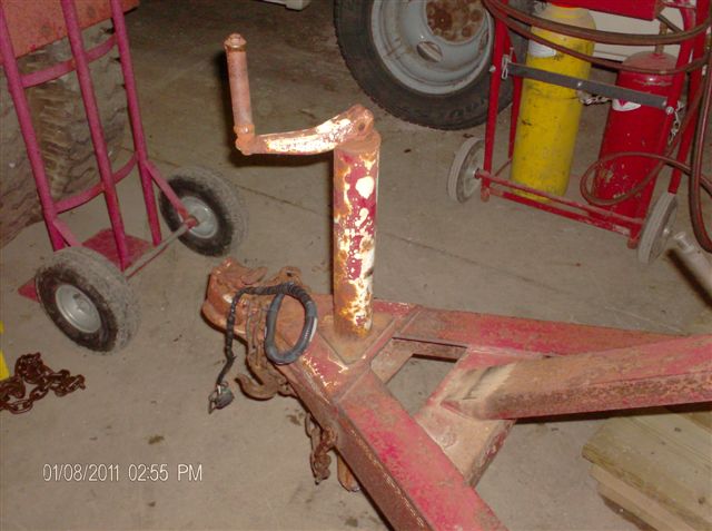

Went to town this morning and picked up carriage bolts for new deck boards, new jack for tongue and Allis orange paint to cover ugly faded and rusted red original paint. Spent the afternoon removing old deck and cleaning up wood. Removed fenders and splash plates. Replaced tongue jack. More pics when progress is made.

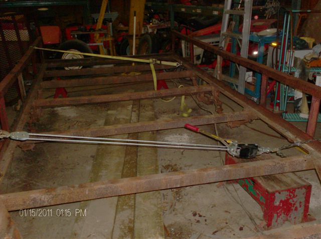

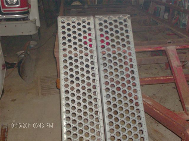

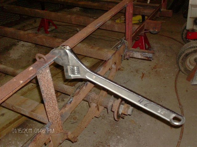

Posted - 01/15/2011 :  19:57:06  Show Profile Send B10Dave a Private Message  Reply with Quote

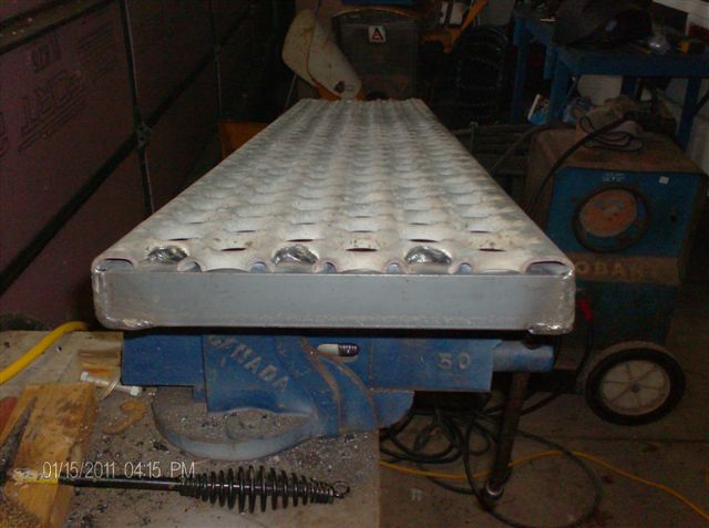

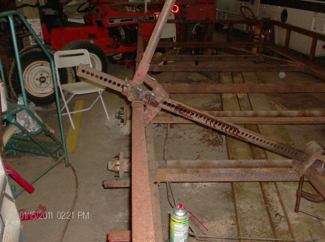

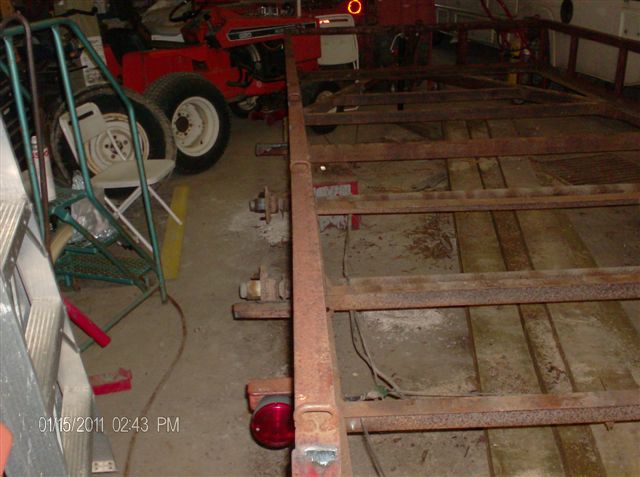

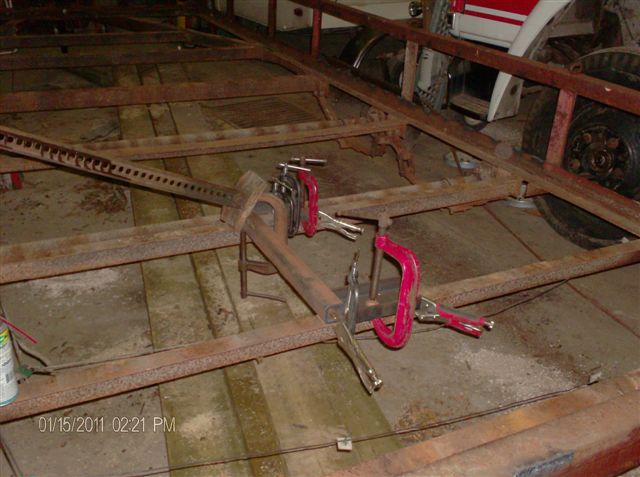

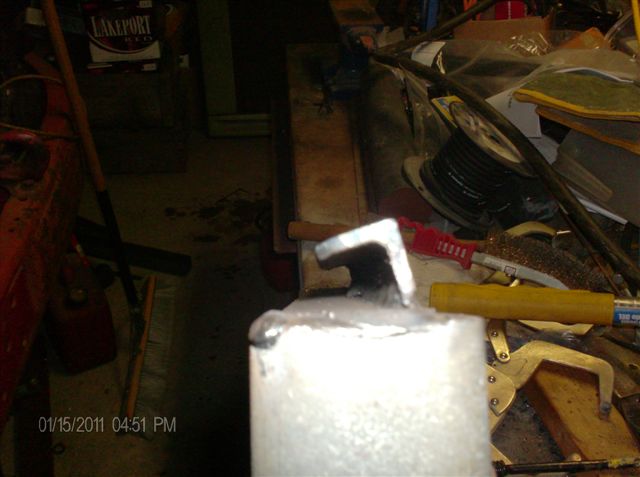

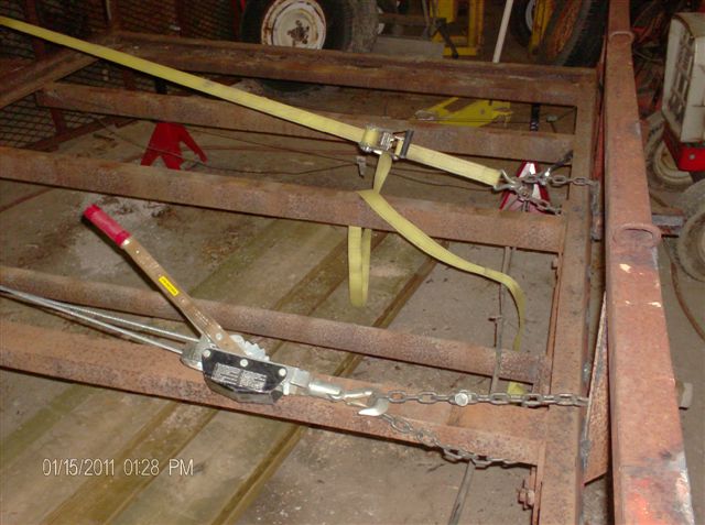

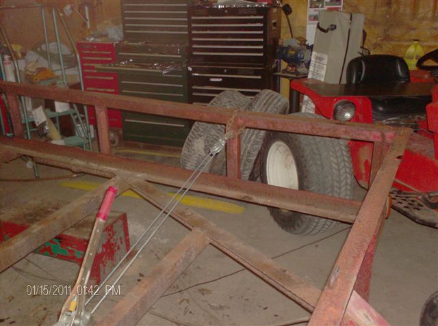

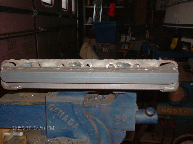

Got more accomplished on the trailer today. Straightened both top rails. Made both ramps same length and welded ends in to strenghen them. welded angle iron bracket to each ramp so they will hook onto the angle iron I will be welding to the back end of the trailer. Last picture shows how I finished the day. Dave
Posted - 01/15/2011 :  20:54:21  Show Profile  Visit simplelife's Homepage Send simplelife a Private Message  Reply with Quote
Dang! You guys have way too much ambition and energy for the middle of the winter! The rebuild is looking good and its interesting to see the fixes and devices to get r dun!
I have a whole list of projects, but everytime I go out to the garage, I stare at them, move a few things around, and pretty soon the cold overcomes my good intentions. Guess I need some more anti-freeze in my veins or fix the garage so any heat I try to use doesn't all leak out of the garage.
Last picture looks like a good engineering session in process!

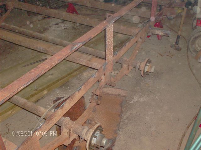

Posted - 01/16/2011 :  01:27:16  Show Profile  Visit BRAD1975's Homepage Send BRAD1975 a Private Message  Reply with Quote
Ive never seen springs mounted that way before ...all my trailers have the spring eye high and the yoke eye low like this
BRAD1975
1562 Posts
Posted - 01/16/2011 :  01:29:14  Show Profile  Visit BRAD1975's Homepage Send BRAD1975 a Private Message  Reply with Quote
oh wait lol....maybe they flipped down when you put it up on stands...nevermind

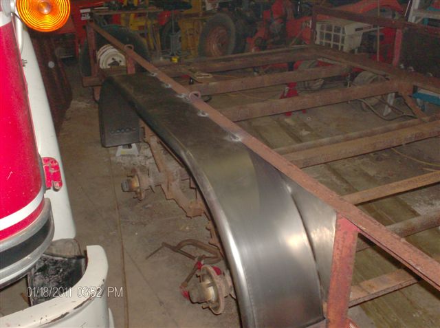

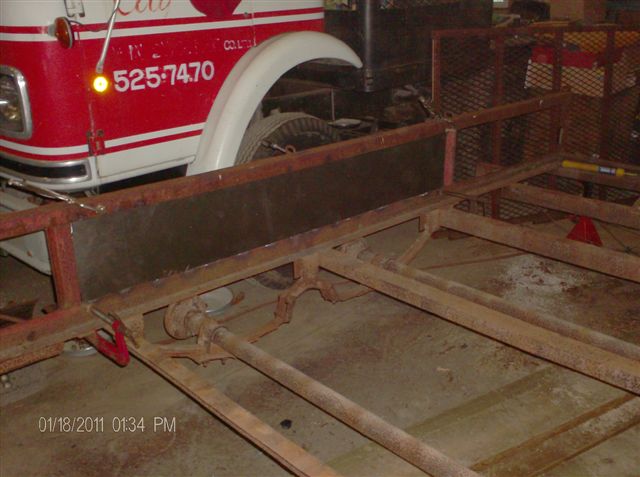

Posted - 01/16/2011 :  20:51:27  Show Profile Send B10Dave a Private Message  Reply with Quote

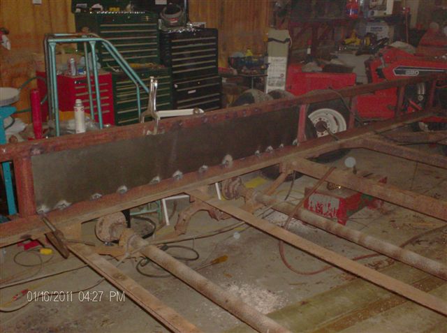

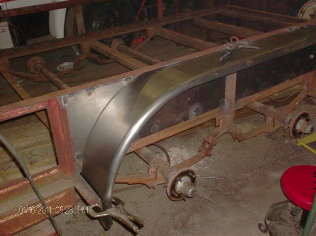

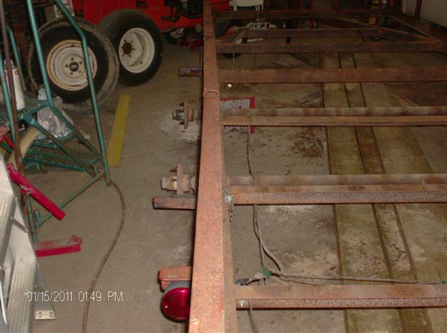

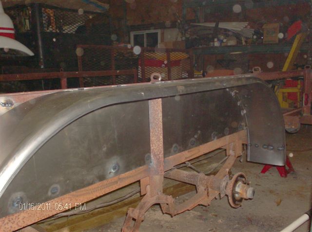

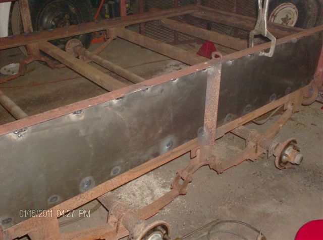

Richard. I won't be going to any auto races. Going early enough but wife wants to see Universal Studios and then we will be going to Flywheelers Park early to vegetate in the sun till show starts. Hope to get to Daytona for a couple of days during Bike Week but that is still up in the air. Went into town today to pick up welding rod; then spent some time in the shop. I ground off all the old welds on left splash shield and fender area. Installed left shield and fender. Hope to get right side done on Tuesday. More progress pics. below. Dave.
Posted - 01/16/2011 :  21:47:21  Show Profile Send Cvans a Private Message  Reply with Quote
Coming along nicely Dave. Have you ever thought about putting a strip of expanded steel down each side of the bed. My trailer came that way and I love it. You can hook your tie down straps any place you need to. The strips are about 18 inches wide and run from the front to the back of the trailer.
Are your shackle bushing still tight? I was surprised at how well they wear for being just plastic.

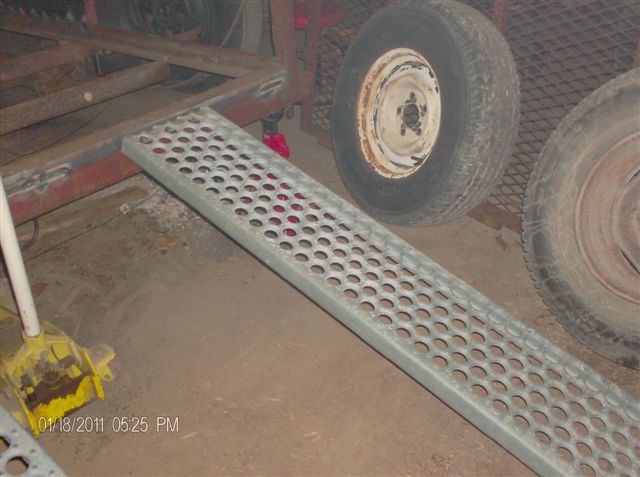

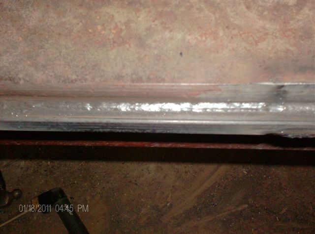

Posted - 01/18/2011 :  20:14:56  Show Profile Send B10Dave a Private Message  Reply with Quote

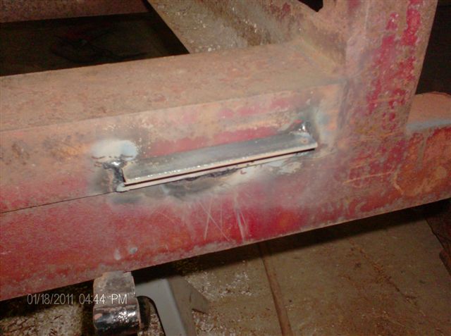

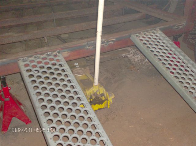

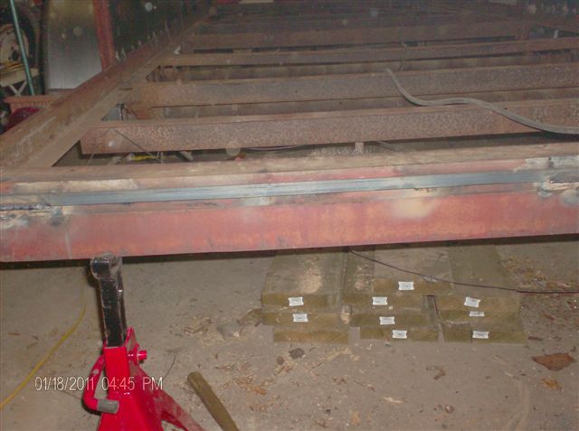

Ground old welds off right side splash shield and fender area. Installed right shield and fender. Made up and installed rear bracket for ramps to attach to. Trailer is still sitting high on stands. Ramps will have less incline when it"s back on its wheels. Only fabrication work left is to make brackets to hold ramps. Dave
