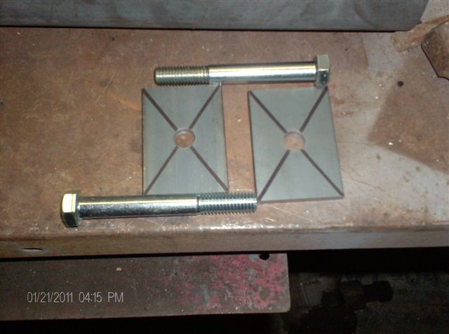

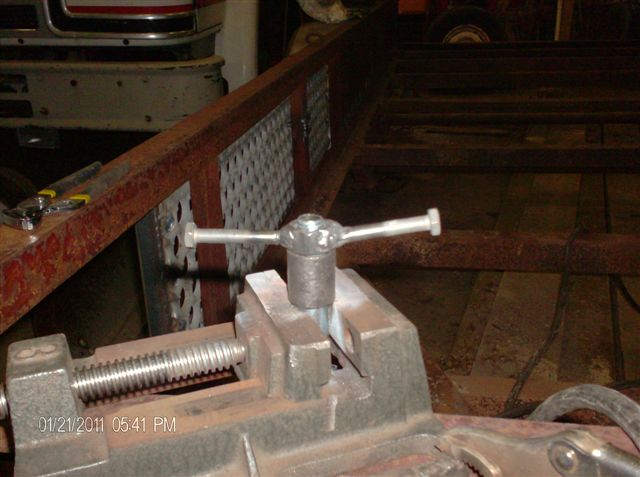

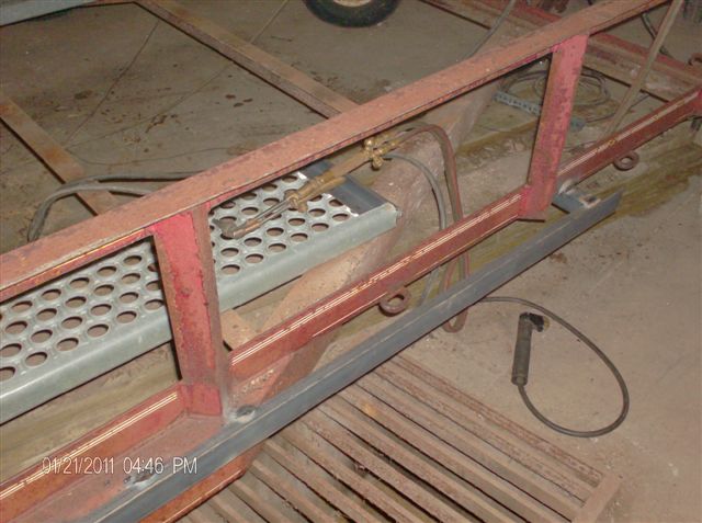

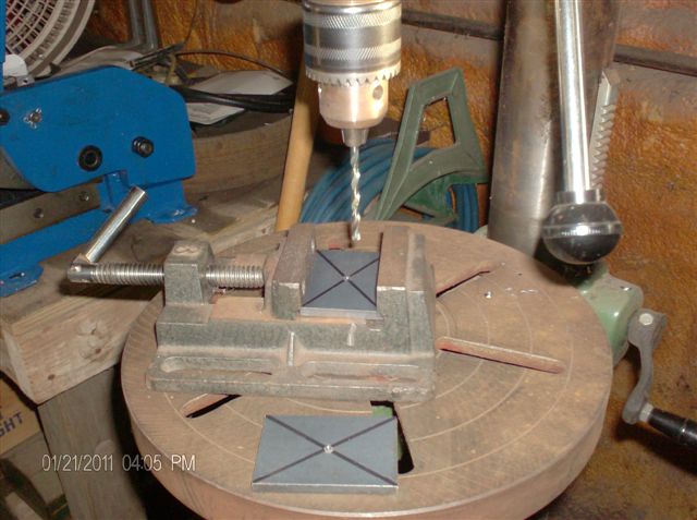

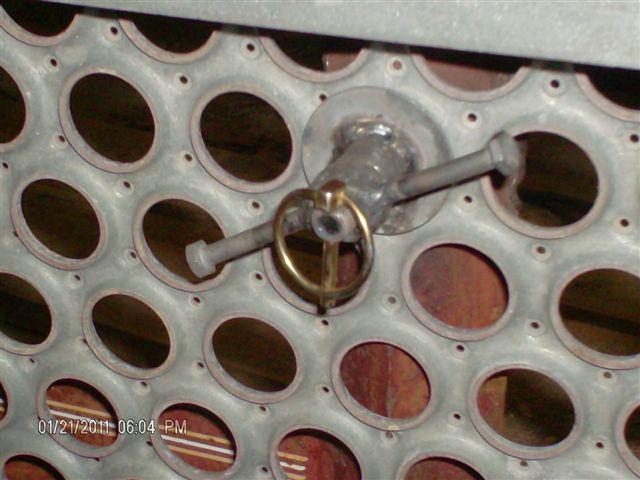

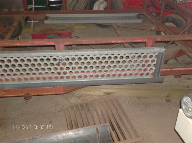

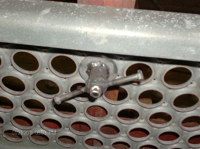

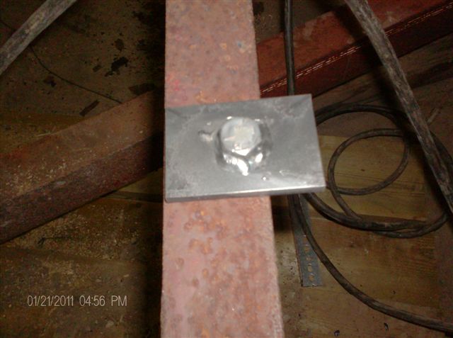

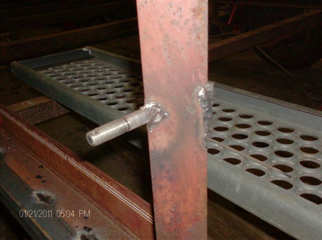

Spent some more time today building ramp brackets and hold down bolts to secure ramps. Dave.
Posted - 01/22/2011 :  00:39:28  Show Profile Send Cvans a Private Message  Reply with Quote
Slick! Last picture answered the only question I had.
Posted - 01/22/2011 :  12:35:05  Show Profile  Visit B-16_IC's Homepage Send B-16_IC a Private Message  Reply with Quote
Slick indeed! Good thinking on the ramp holders, out of the way, easy access, and safe to boot. Nicely done.

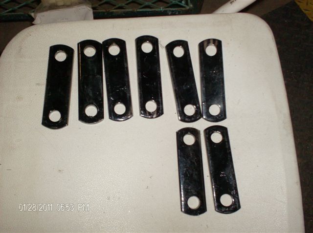

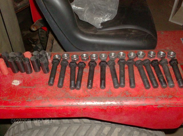

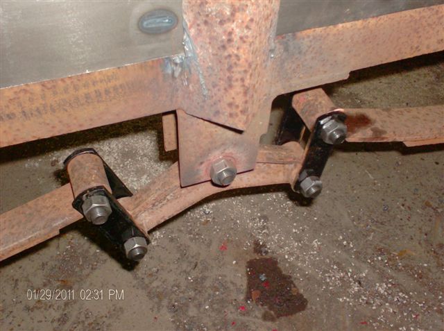

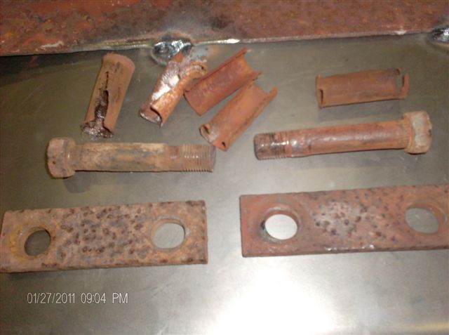

Decided to recheck spring hangers and bushings for play. I had only checked front bushings on front springs; they had little to no play. Glad I rechecked rest of the bushings. Worn out and also the pivot bolts. Picked up new parts today and started to replace bushings and bolts. Well who would have thought the side plates would have elongated holes when the bolts are captive and pivot in the bushings? Silly me!! I will be picking up 8 new plates tomorrow to complete this job. B10Dave

We just went through this same program on my Son's 20ft snowmobile trailer this afternoon. He was on his way home with 4 snowmobiles and just outside of North Platte Nebraska a leaf spring broke. After today he has new springs,bolts,and bushings. We also modified the frame so that the tires weren't so close to the frame. Was built so that if the trailer was loaded heavy on one side the tires sidewalls would rub. Got all done and discovered that one axle was bent.
I know your going to feel better about pulling your trailer down the Hi-way when your done. I think those plastic bushings would last longer if the shackle bolts weren't prone to rusting.

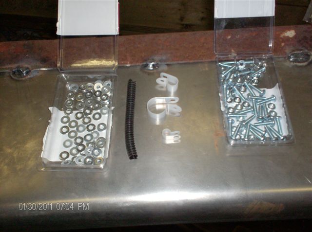

Thanks for the tip Chris. Tidied up the wiring today and added protective loom. Will be starting general clean up and paint very soon. Dave.
