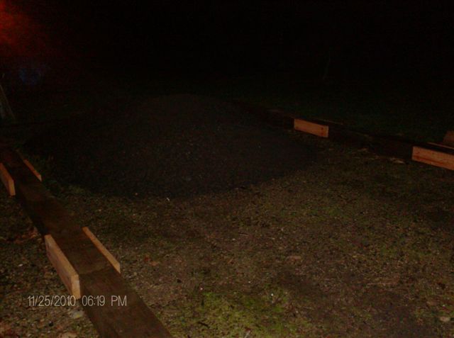

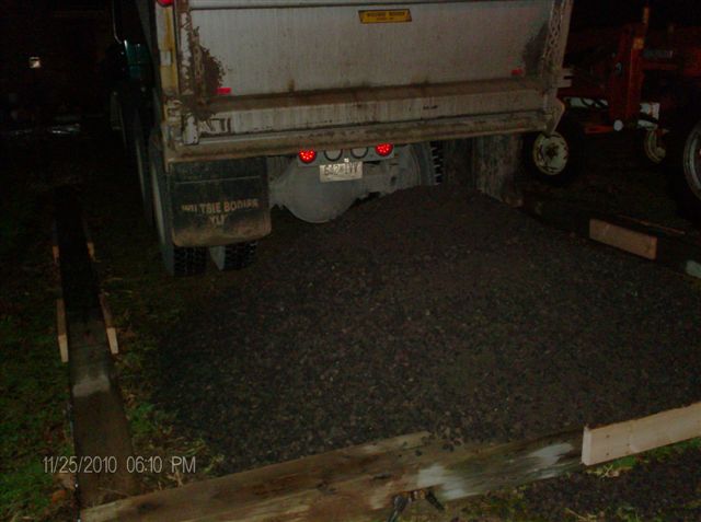

Doug, What's a building permit? LOL. Brad, The setup from Western Tarpaulin is UV treated so it should stand up to the sun for about eight years before a replacement is needed.I brought some recycled asphalt home today to make a floor. It was late in the day so pics are dark. Dave.
Edited by - B10Dave on 11/27/2010 13:30:24
Posted - 11/27/2010 :  14:53:58  Show Profile  Visit olcowhand's Homepage Send olcowhand a Private Message  Reply with Quote
I hear that recycled asphalt makes for a great surface. Pack it well & it's almost like fresh lain pavement.

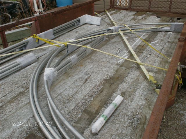

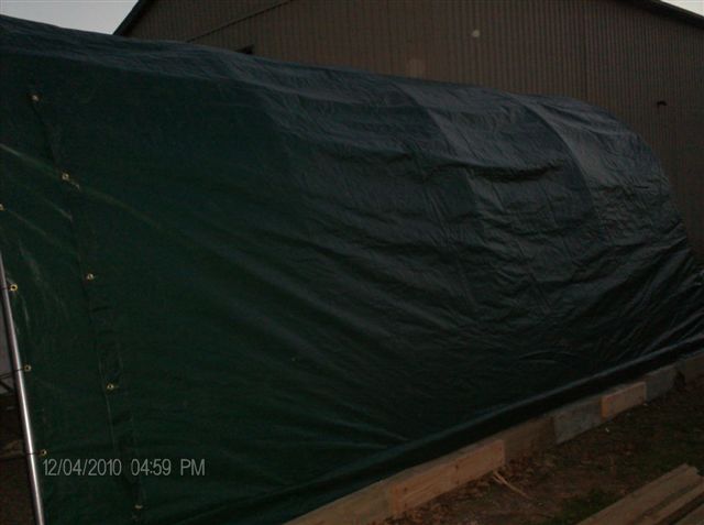

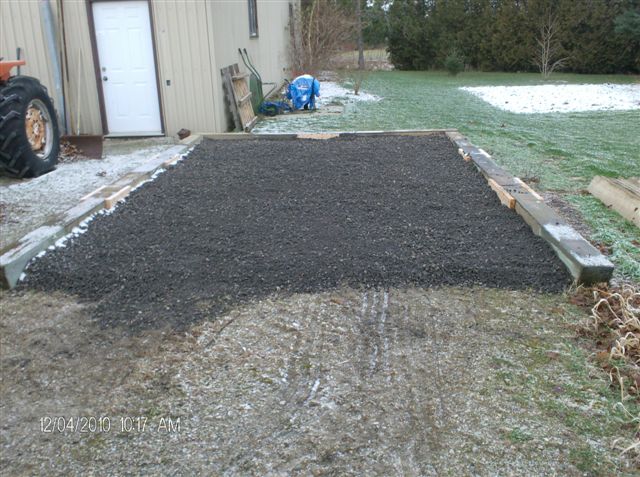

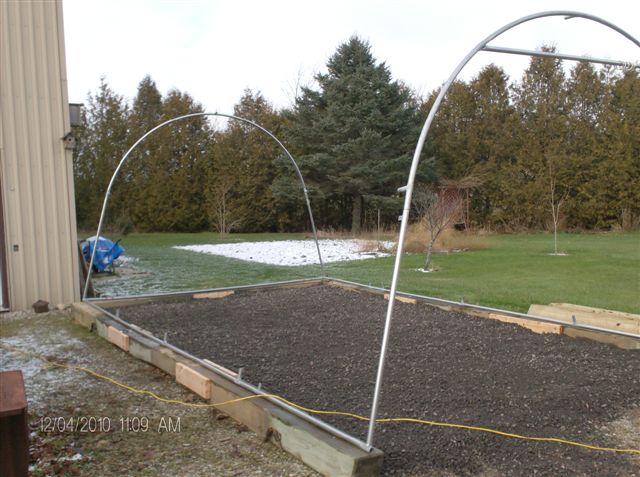

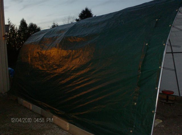

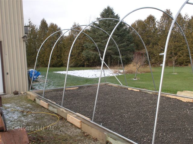

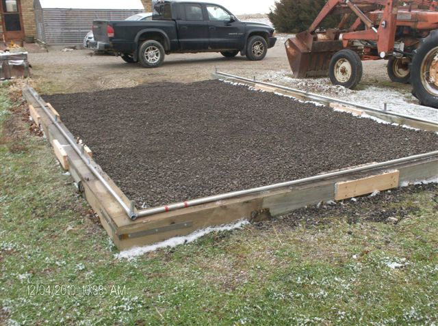

Picked up my portable garage on Thurs. Spent today putting it together. Only thing left to do is rent a plate tamper to compact the recycled asphalt.
Frame is all assembled and screwed together. Next two pics show cover on but not tensioned. Last pic shows nearly completed interior.
Did the whole project witout any help. Gave me a great sense of accomplishment. B10Dave
Posted - 12/05/2010 :  01:33:35  Show Profile  Visit B112's Homepage Send B112 a Private Message  Reply with Quote
Absolutely looks great! Did you put ground plastic under the gravel? That is what I was told to do to stop ground moisture from coming up. I put two layers of thic mil pastic under my gravel. May not be necessary in your area.
Posted - 12/05/2010 :  14:54:02  Show Profile Send B10Dave a Private Message  Reply with Quote
Michael. Didn't put anything under recycled asphalt. Thought about it thirty seconds after truck tailgate opened. Way too late then. Dave.

It must be pretty dark in there?..or does the fabric has some translucency to it?
I been thinking about one like that for next time after my $200 one from costco finally gives way in a windstorm but the price seems pretty high at $799
Posted - 12/14/2010 :  21:24:36  Show Profile  Visit B112's Homepage Send B112 a Private Message  Reply with Quote
Brad, I have a similar unit and you do get light in there. They work great. If I were to redo mine and reskin it, I am going to build slightly higher inner walls and put in cement. That way you can go right up to the sides.
