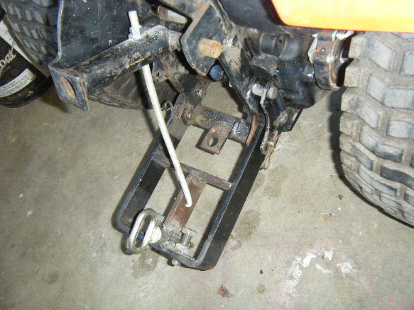

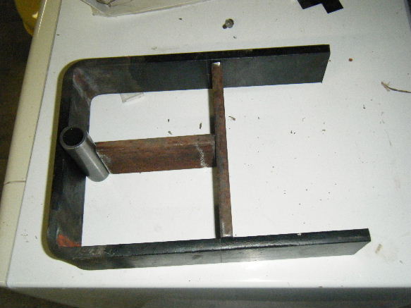

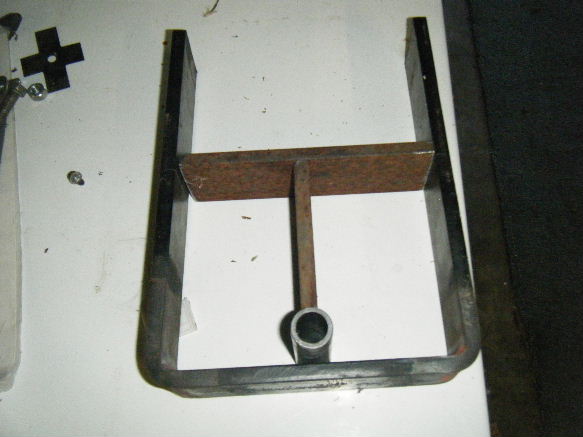

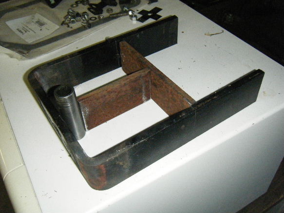

All I have to do is drill five holes, the two hitch pin holes, two stabilizer bolt holes, and the clevis hole. Then I can weld it all together

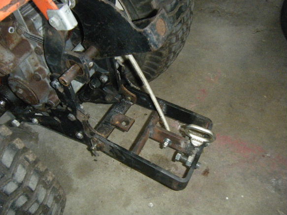

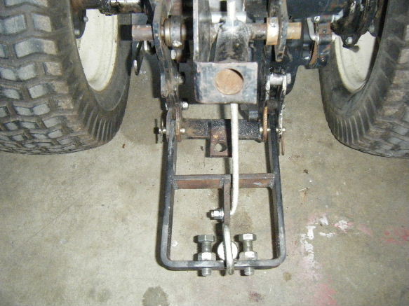

Posted - 07/30/2010 :  18:00:33  Show Profile  Visit ATF's Homepage Send ATF a Private Message  Reply with Quote
Okay, I ain't the best welder or fabricator, but I reckon this oughta do. I may change out the lift rod with something stronger, so feel free to offer suggestions/criticism

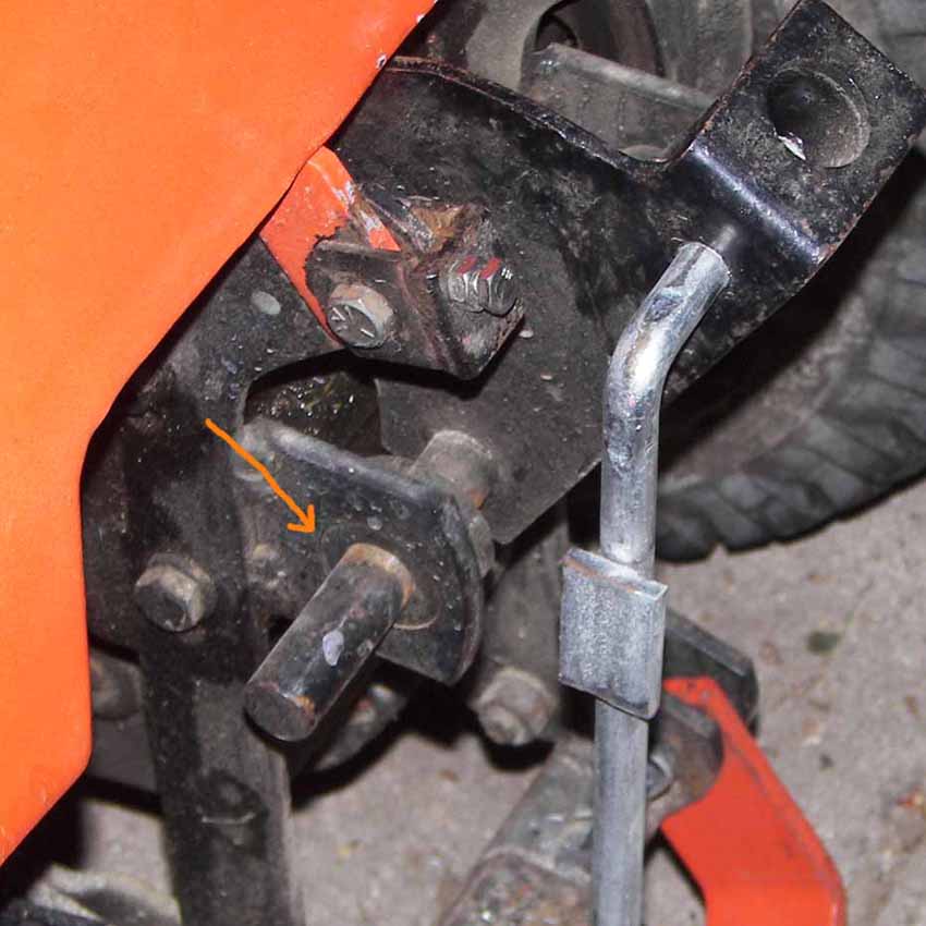

Posted - 07/30/2010 :  21:45:15  Show Profile Send skunkhome a Private Message  Reply with Quote
mike, I am afraid your lift rod is going to bind a bit. This is what I did to remedy that problem. disregard the orange arrow.
That position turned out to be too far out and I have since then redrilled the hole 2 3/8" away from the pivot shaft. Once I get a little more proficient at welding I plan to weld a tab with a hole at the bottom edge of the lift lever to emulate the later models.

Posted - 07/30/2010 :  22:02:23  Show Profile  Visit ATF's Homepage Send ATF a Private Message  Reply with Quote
I gotta learn to read your emails several times, I don't know how long I looked at that orange arrow, lol, I THINK I know what you mean. My lift rod hole goes vertical through the bottom of the tube, yours is drilled vertical higher up on the lift tube. Thanks
Posted - 07/30/2010 :  22:11:29  Show Profile Send skunkhome a Private Message  Reply with Quote
Mine is drilled horizontally but don't drill it too far away from the pivot point as I did (took three men to lift a ten inch plow). ....drill it about 2-3/8 inch up the tube.
Edited by - skunkhome on 07/30/2010 22:11:56
Posted - 07/30/2010 :  23:41:06  Show Profile  Visit ATF's Homepage Send ATF a Private Message  Reply with Quote
I think I got it, because where mine is now is way lower, right.
