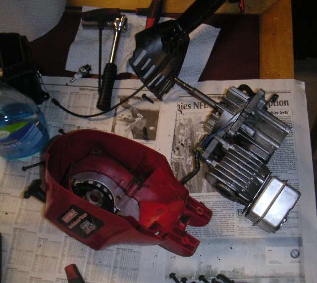

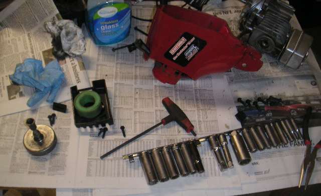

So this is the trimmer apart/the work area:
All comes apart easy! Just a few T-Hex wrenches.

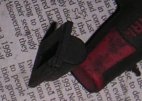

Here's the mysterious rubber piece. In shot two above also.

Posted - 06/05/2010 :  09:16:08  Show Profile Send oldron a Private Message  Reply with Quote
Just a rubber mount,my Homelite has 2 or 3 for the gas tank.I think they are for vibration lol.

I can't really see the rubber piece that well but with my 2 cycle experience it sounds like it would be for a fuel hose going into the tank or a vent line out. Also, with an abrupt stop where it hit something it's likely you've broken a keyway. I know about Biggies dislike for 2 strokes and I can understand the experience after tons of unsuccessful attempts at yanking the the starter rope and turning these into boomerangs but one thing I've found that does loads of initial problem solving is to make up a soda bottle with a hole in the cap and put some fuel mix in it and pull the spark plug to give it just a small shot of fuel before yanking for a half hour to get the fuel through the lines. Don't put too much in as it will likely be too much for the cylinder and it will bind but just enough to yank it over a couple times with the choke on. Usually within a couple of pulls it will start and run long enough to get the fuel up to the carb IF it has spark. Usually with a couple starts and stops with this method it'll pick up and run. If not it's spark or a bad diaphragm in the carb. Pull the carb apart and just clean out all the passages with carb cleaner and make sure the passages are completely clear. I've used various size torch tip cleaners for the really hard ones that works amazingly well..
Posted - 06/05/2010 :  10:22:47  Show Profile  Visit olcowhand's Homepage Send olcowhand a Private Message  Reply with Quote
Being it won't start, likely Richard is correct that the flywheel key is sheared. Timing will be off, but there will be spark.

It looks to me like one of those things that sits on the workbench, and six months down the road you spot it, then wonder 'what is that?', then pitch it in the trash can. Of course, by then you have already pitched the 2 cycle from he** and sworn off anything 2 cycle and bought a goat for the weeds, or of course, bought a new weed eater, while looking in to buying an electric chain saw to match your electric weed eater.

I think Ryobi also made/makes the Crapsmans and they also have a rubber bumper on the gas tank. I would bet the with the sudden stop that you have sheared a key or something throwing off the timing. you also have primary and secondary compression and if the reed valves are damaged or corroded the thing will not run.

It'll still have spark with a sheared key...just at the wrong time, and can or can't even try to hit a lick, depending on flywheel location on shaft.
