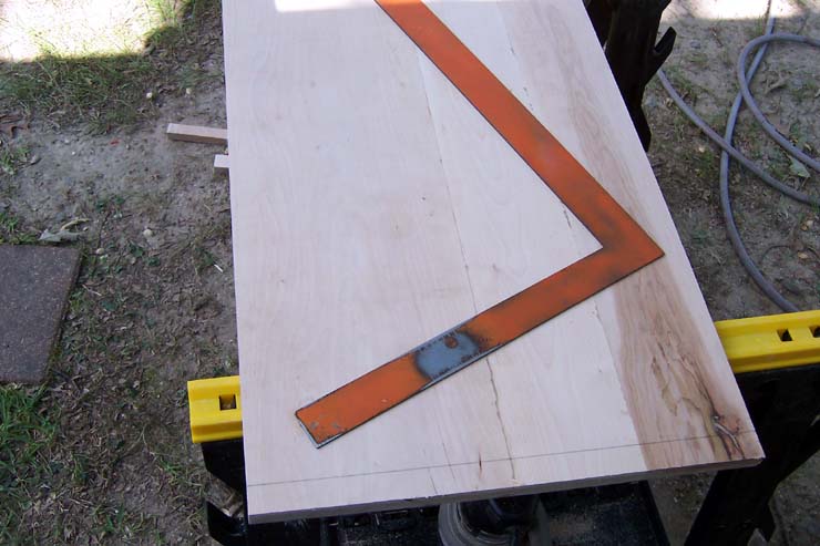

What do you do with a framing square when it no longer is? Square that is.

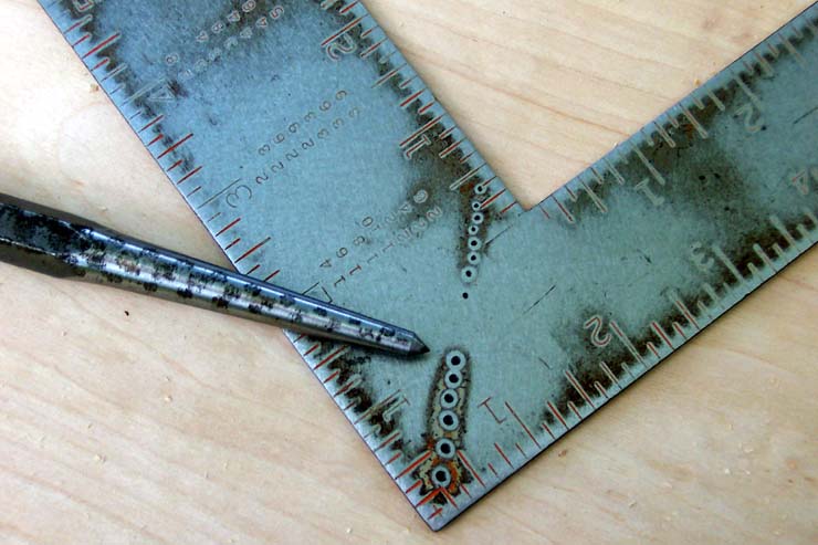

Any how the old carpenters would punch them with a center punch to push or draw 90%.Or frame it and call it liberal square deal!
Posted - 05/29/2009 :  22:05:18  Show Profile Send skunkhome a Private Message  Reply with Quote
Well they will stay square if you don't step on them or stack your tools on them. The square above was 1/8" out "Obtuse" at 22".
I had read some where about the center punch trick and it does work. Square is once again "square".
