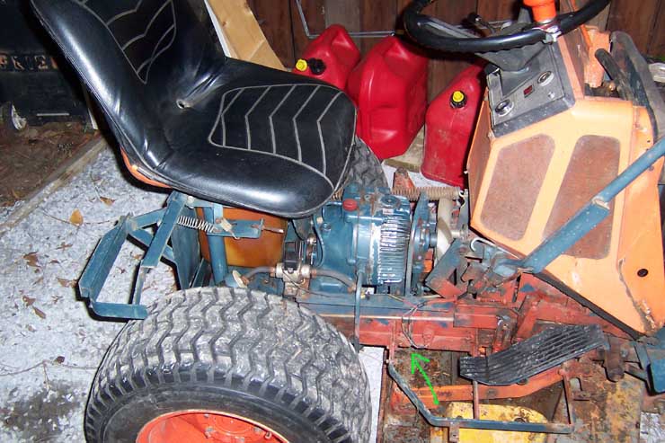

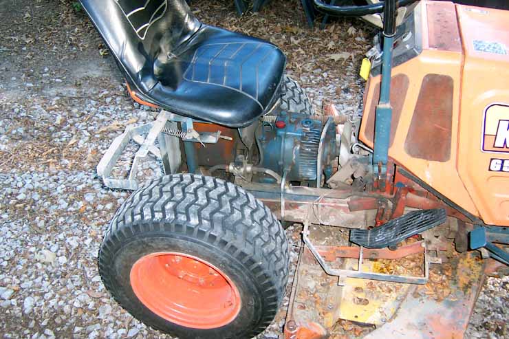

Posted - 10/19/2008 :  20:56:53  Show Profile Send skunkhome a Private Message  Reply with Quote
I finally took the rear shroud off my Kubota today Just to look around. I must say that I know little more than I did before.
The channel iron frame was full of caked on mud and grease so it was pretty hard to see much of anything.

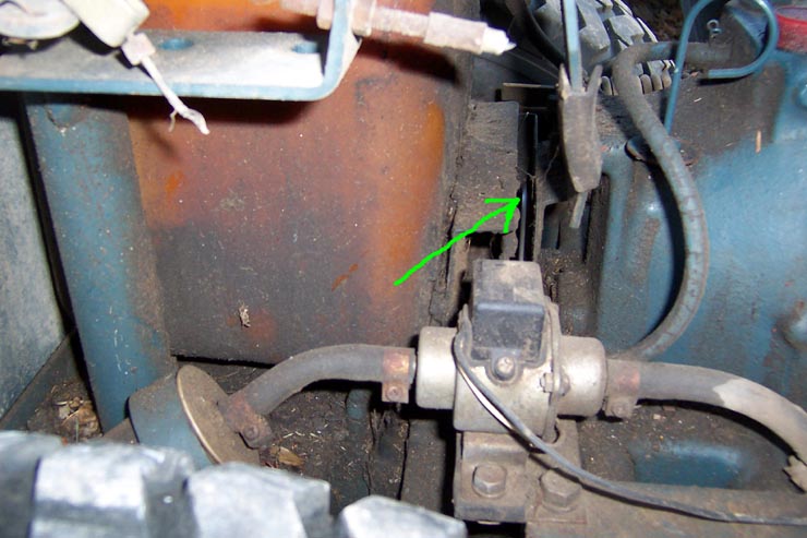

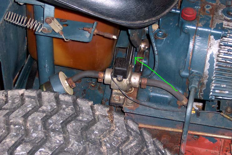

I was particularly interested in the brake disc which rattles like crazy (green arrow). It floats on a spline shaft and is held in place by a "C" clip. It wanders back and forth on the shaft until the brakes are applied. It is pretty noisy but I can't figure how to get to it without doing a lot more dismantling of the tractor. Maybe a coating of heavy grease on the shaft would stop the rattling.
A little clean up allow me to see a better and discovered some rust through on the bottom rail of the frame.
Even with years of debris removed I am still unable to tell much about the disc brake. My manuals aren't much help either. I guess I just need to start taking things apart and see where it takes me.
Edited by - skunkhome on 10/19/2008 21:13:50
Posted - 10/19/2008 :  21:12:30  Show Profile  Visit olcowhand's Homepage Send olcowhand a Private Message  Reply with Quote
Well, you have an Eaton model 11 hydrostat unit. Same as on my Unico 15 made by MTD. Many makes use the Eaton 11. Good hydro's.
Posted - 10/19/2008 :  21:24:42  Show Profile Send skunkhome a Private Message  Reply with Quote

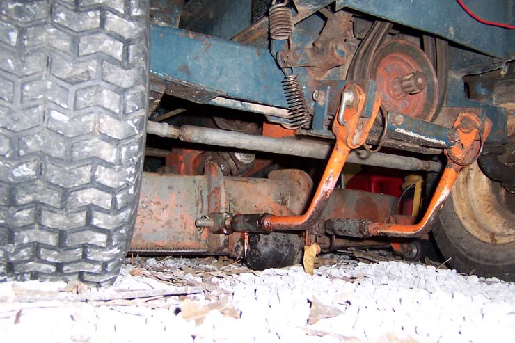

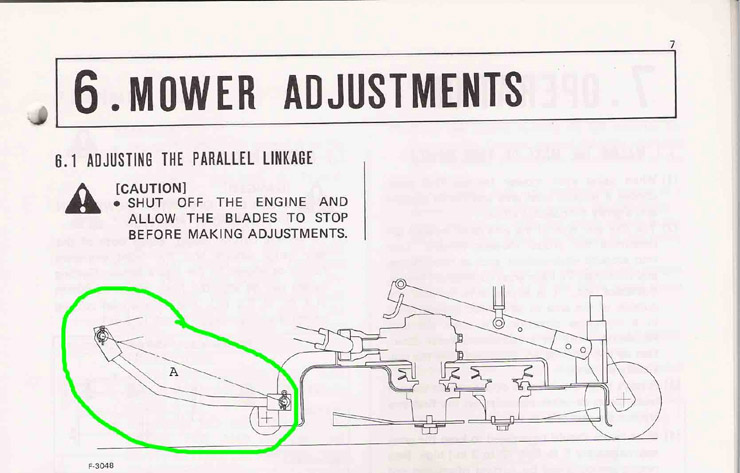

I am really pleased with the transmission and engine. Mower is giving me grief though. I think the key now is the front links which I believe are too long allowing the front of the mower to dig even in the raised position. I don't know what length they need to be. It would be helpful to get that length "A" from pin to pin as one of the turnbuckles is welded on one end so it can't be adjusted in place.

Posted - 12/23/2008 :  00:22:35  Show Profile  Visit ZippoVarga's Homepage  Send ZippoVarga an AOL message  Send ZippoVarga a Yahoo! Message Send ZippoVarga a Private Message  Reply with Quote
I wouldn't grease the spline shaft that the brake disc rides on. The grease will sling onto the brake disc and really cobble things up. Then you'll HAVE to tear it down to get it degreased. I suggest a couple rubber bushings to quiet things down. One on either side. Also, if you're feeling ambitious and do tear it down, a little anti squeal behind the pads will help some of the chatter also. IMHO of course.
