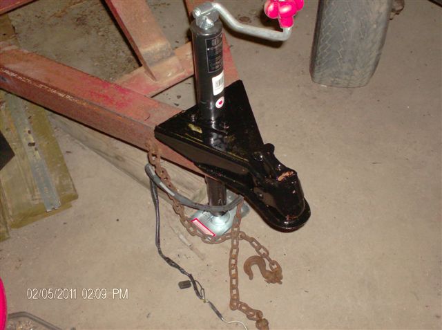

Moved stuff in the shop yesterday and put some in my new storage building. This gives me just enough room to get my trailer in for a rebuild before going to the GOTO in Florida in February. I will be redecking it, straightening one top rail, replacing the fenders and splash plates, changing the rampgate to stowable ramps (to lower towing air resistance), replacing tongue jack and hopefully a paint job. Here are the before pics and I will post more as the job progresses. Dave.

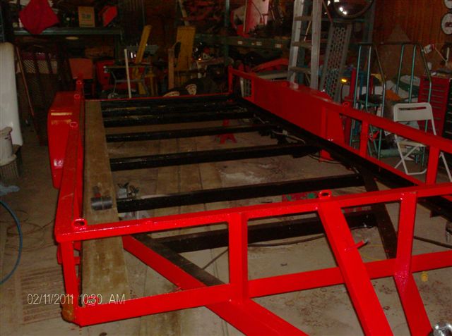

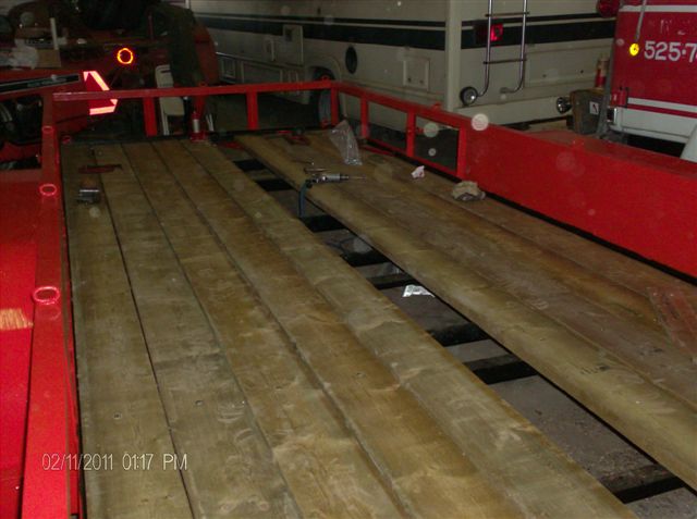

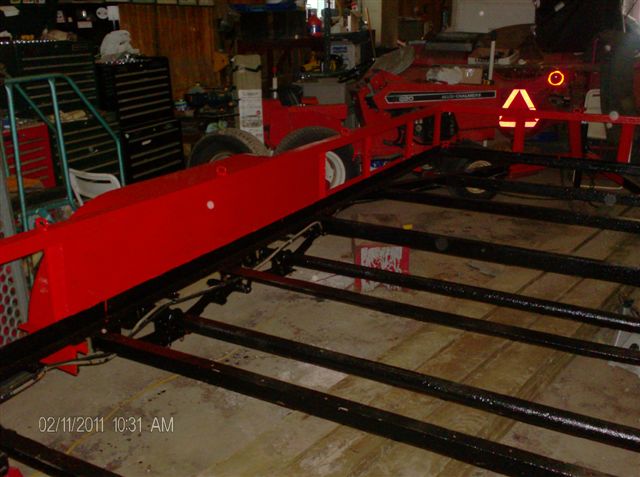

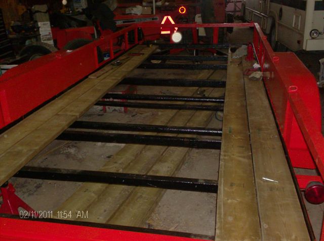

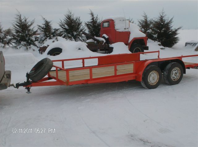

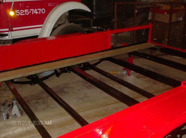

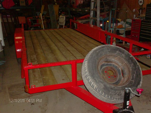

B10Dave Posted - 02/11/2011 : 21:58:48
Well it's done. Except for the wheels. I will paint them when I get back from Florida. Here are the last pictures. Dave.

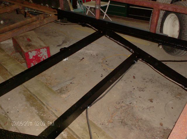

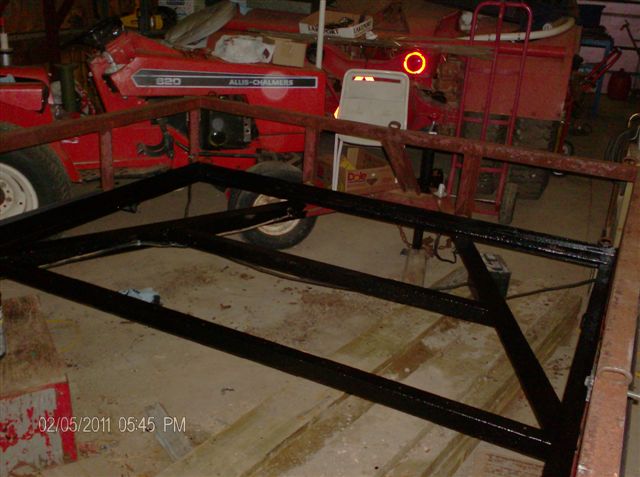

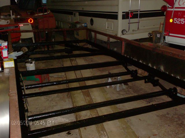

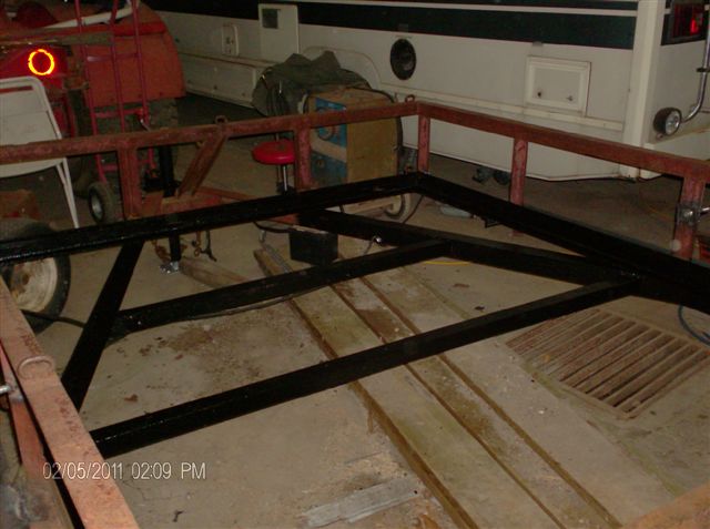

B10Dave Posted - 02/05/2011 : 21:19:18
Getting closer to done. Painted lower frame and inside of suspension today. Tomorrow after I'm done blowing snow I will paint outside of suspension and underside of fenders. Maybe start on the orange as well. Dave.
B10Dave Posted - 02/01/2011 : 00:18:39
Doug. Clamps sound like a good idea. I am just making the wiring safe and secure for now. As for the snow; we get what we get with no control so I will deal with whatever comes my way. Hopefully the weather gurus are wrong again and will be exposed as the chicken little's they usually turn out to be. Dave.
dense1 Posted - 01/31/2011 : 18:45:00
Dave.
When I re-wired mine, I used grey PVC electical conduit and junction boxes, was told it would help to stop road corrosion, Then next year I plan to use the heat gun to rebend the conduit (where required) and secure to the deck with galvenized pipe clamps. I think this would be better than the zip ties I have now(LOL). Good or bad idea?
Just a point to ponder.
Respectfully Doug.

B10Dave Posted - 01/30/2011 : 19:40:54
Thanks for the tip Chris. Tidied up the wiring today and added protective loom. Will be starting general clean up and paint very soon. Dave.
