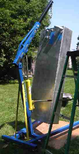

Anyone ever hear of HTS-2000 or use it? I am planning on using it for an aluminum gas tank repair.
HTS-2000 Aluminum repair:
http://www.youtube.com/watch?v=N-cv3R4fWZc

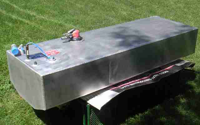

B112 Posted - 08/16/2009 : 16:49:09

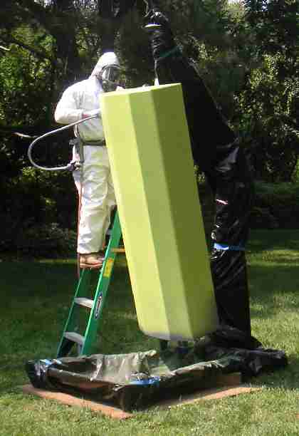

Update: A weekends work moving the gas tank project along. My friend is painting this for me who's painted his boat and invested in a respirator system to protect the lungs.
Well this is the new tank ready for painting (scuffed up w/300 grit and acetone cleaned):
Setup for painting:
Primed with Awegrip primer being coated with a grey topcoat:
Final tank ready for installation:

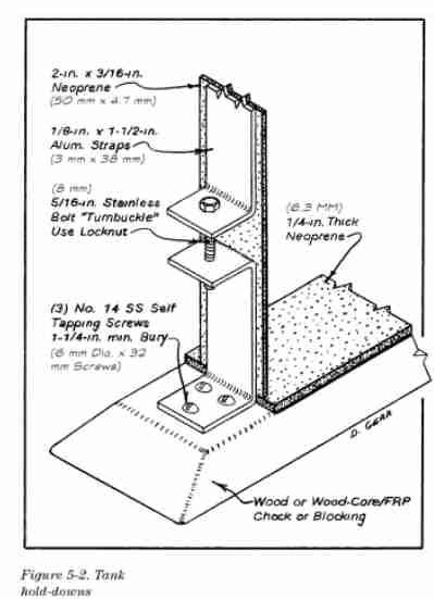

B112 Posted - 08/01/2009 : 07:40:51
Unfortunately, those were not made for a 145lb tank holding 600lbs roughly of fuel. My original straps broke at the bends. So I'm thinking of making something like this:
Except the top hold down would be only a straight bar. Now I may make this from 1/4" aluminum verses the 3/16 aluminum which broke. The side brackets would go to the top of the tank instead of half way as shown and the top bracket being straight would either be straight or have that same bend but shallow. I'd reenforce the bends with triangle braces so I don't break at the welds.

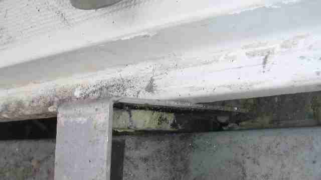

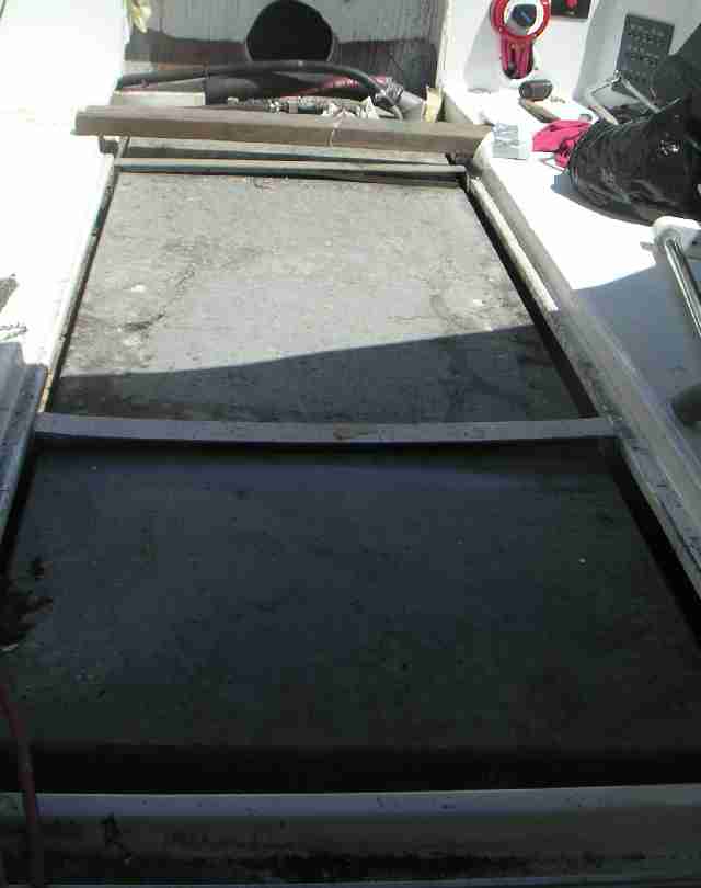

B112 Posted - 07/12/2009 : 05:49:01
Now I need to figure out a way to strap this tank back into the boat. The original straps shown broke. With the tank out, I could secure straps where the old ones were and mate those on the top of the tank. I'd need somethings which will not hurt the tank.
Here's how the old tank looked in the boat:
I'm thinking of an idea sort of like how the Simplicity gas tanks pull the wrapping strap together. What ever I use must not rust, so I can't use plain steel.
Here's a closeup of a strap and the space between the deck:
Any ideas?
