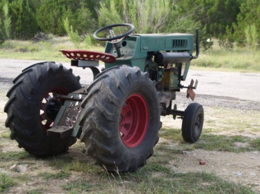

After swapping the 31x15.5x15 tires from Suburban to my Powermax I wanted a new setup for the Burb.
After mounting these other 15" wheels with lugs the tractor set with to much foward rack so I remounted front axle to level things out and extended wheelbase at the same time.
I'm now happy with the stance and it handles well. Just gotta build the fenders, 3PH and repaint.

The tires are 12.5-15L On 15" Jeep wheels. With the high/low ranges there was no need to change gearing.

that thing looks great.did you change the pulleys to gear it back to stock and what size rear tires are you running?

That thing is a beast!!! My '69 ss12 just crawled under the bed!

I see you've got the all important mud on the tires! Real tractors ain't clean! Nice job on the rippers, look better than some of the boughten stuff I've seen.

Got the rippers welded up and some paint on box.

Electrified the original 3PH and built a 44" box blade from stock on hand. Soon as I acquire the rest of the hydraulic parts, the electric will be changed.

There is no exhaust note to be heard above the Wisconsin AENL. By the way that is an Onan RV generator muffler.

Does the long muffler cut down on the engine noise? I like your hydraulic setup.

I must have been thinking "Oliver". The running boards dispelled some of my concerns about the open wheels. It is not pretty to be sucked under the wheels of your own tractor.

It's still a long ways from where I want to get it, but here's 3 pic's. The last shows the extended floorboards with a 2" lip at the rear to keep my feet from getting into the tires and it works well.
Phil, I had to try this odd gray I had.

Sears would not recognize that tractor...very retro looking with the flat spoked rims. don't know what you plan on painting it but I think red rims on a dark green tractor would look very classic like something out of the 1920's.

Thanks Andrew, I got around to painting the hood and rims and will post pic's after washing tractor.

I vote for no fenders!! That thing looks real tough as-is. Looks like it's a good project for you- keep up the great work!!
