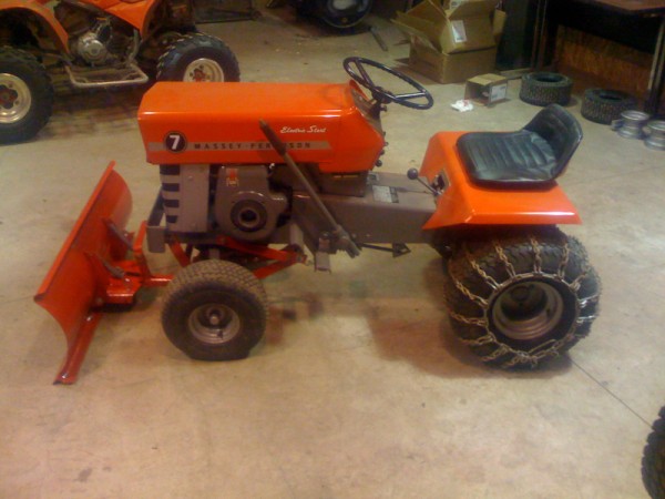

Just bought 2 MF 7's for $126.00. 1st one runs and 2nd one doesn't but it came with a plow. Both have decks. Going to pick them up tomorrow unless we get the snow they are calling for. I will post more pics when I get them home. Looks like I have more projects then time. Oh well.

Thanks. I was really surprised at how well this little 500lb tractor pushed snow. I loaded the rear tires with 5 gal. of ww fluid and it works good. No spinning. This one may be a keeper for the home yard. Sell the newer craftsman.

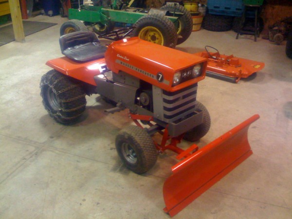

Here are some pics of the finished tractor with the plow mounted. Let me know if you need any close ups.

Nice tractor! Do you have pics of the blade pieces you have? I have an MF8, and found a plow in my Grandpa's basement for it- Just wondering if it's actually for the MF8 or not-

Got a little more done tonight. Had an extra set of 20-10-8 tires. Put them on and now it doesn't look quite as small of tractor. Still have to get the fronts. Anybody know how the plow hooks up? I might have all the parts, but not sure.

Been working on the Massey for a while. Got the chassis painted and some of the little parts. Painted all the red last night.
Started putting some together today.
Also cleaned the points on the engine and it fired right up on the bench.
