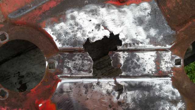

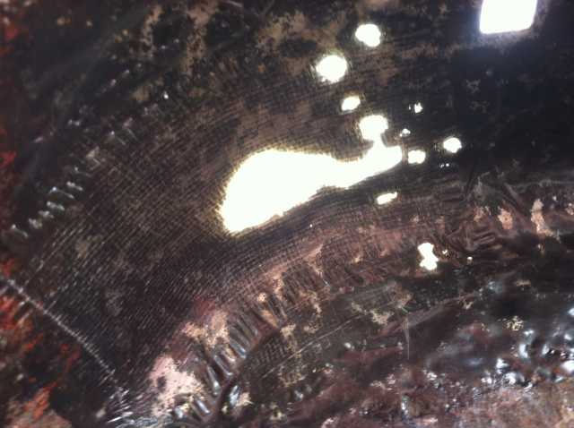

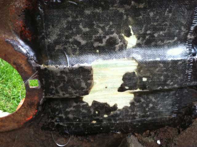

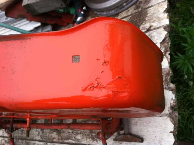

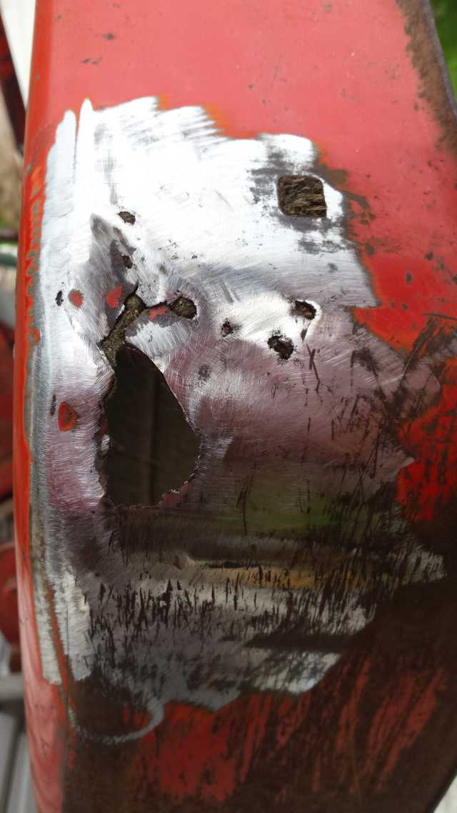

Finally getting around to posting this repair following MDB's deck repair.
Saved a broadmoor 36" hopefully for a long time.
Kind of out of order.

Only one thing. I think I would find some 1/4 X1-1/2" bar stock to stiffen and bridg that gap rusted in the stamped channel between the arbors. Those channels are stamped in there to stiffen the deck.
Posted - 08/05/2016 :  17:26:29  Show Profile Send Cvans a Private Message  Reply with Quote
This is worth considering.
