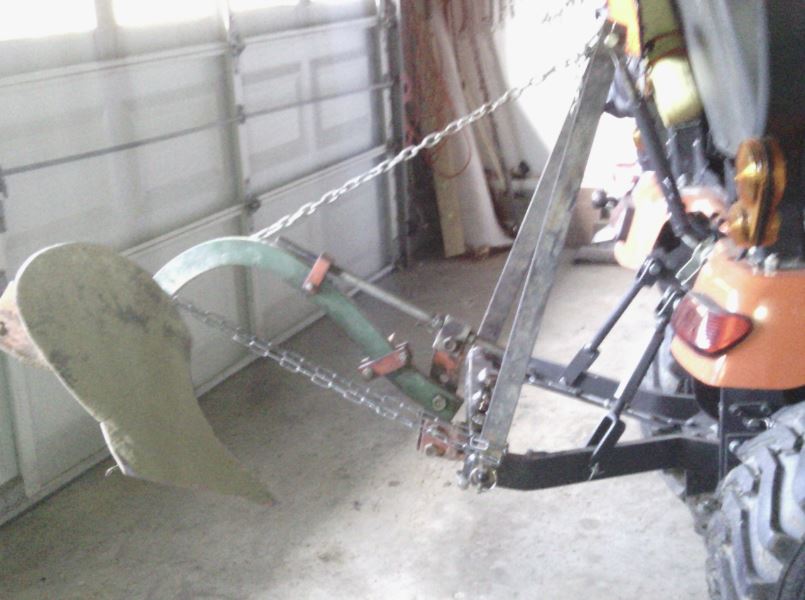

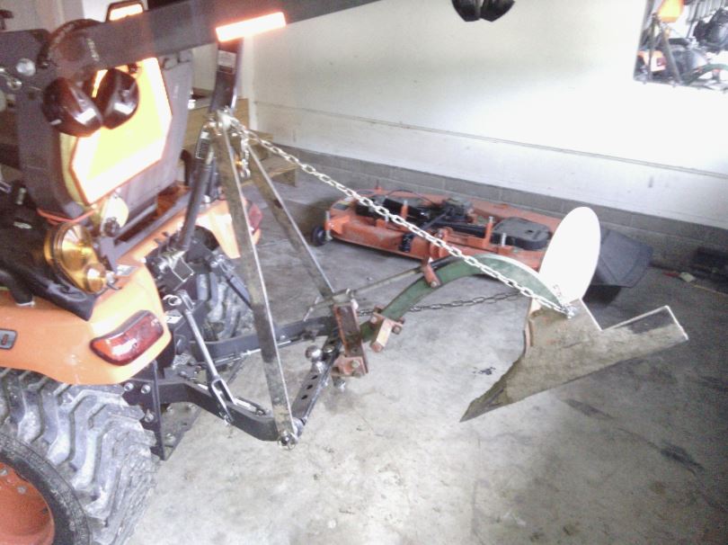

Has anyone ever converted the plow for an AC 314 to a 3 pt hitch? I also have a Kubota BX 2670, sorry for mentioning it here... But I'm thinking I can use the same plow by changing the way it attaches. Any pics would be great. THANKS'....
Posted - 06/17/2015 :  15:05:32  Show Profile Send skunkhome a Private Message  Reply with Quote
Might be easier to make a single point hitch to go on your kubota, and just lift the plow with a cable or chain attacked to a bar attacked to the 3 point lift arms.

Ok. I have the plow from my AC 314 working on my other tractor with 3 pt hitch. Thanks for the input.
Posted - 09/28/2015 :  09:16:12  Show Profile  Visit B112's Homepage Send B112 a Private Message  Reply with Quote
That's the way to do it! You use the draw bar attachments which offer a sleeve hitch point. I actually am suggesting someone with a Mule to do the same thing and we use an electric winch to raise it.
