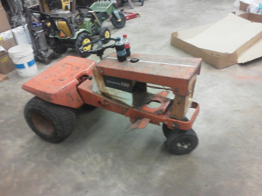

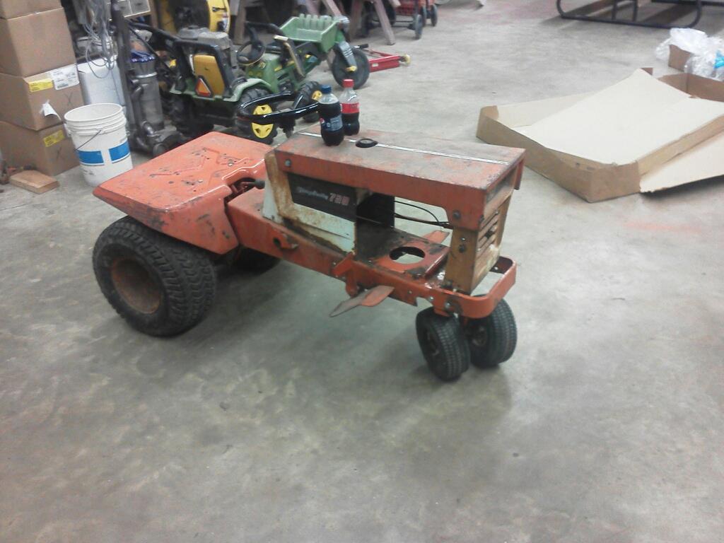

This started out as a Homesteader from Rich. I decided to make it a 728 though with the parts sheet metal i had. I need to get an engine wish i might have to raise with the steering linkage. but i cant raise it too high. I know where a 14 hp kawasaki and a 14 hp briggs is that i might put in it but i dont think they will fit under the hood. for some reason the steering linkage pic wont upload

Do you have any pics of how you mounted the narrow front wheel setup?

Not right now. There's a hole not quiet centered on the frame thats honed out and have a pipe that goes thru it. Welded the pipe in. Cut one spindles and welded the axle on the other spindle. Then cut the spindle shaft and welded it to the other shaft to make it longer.
