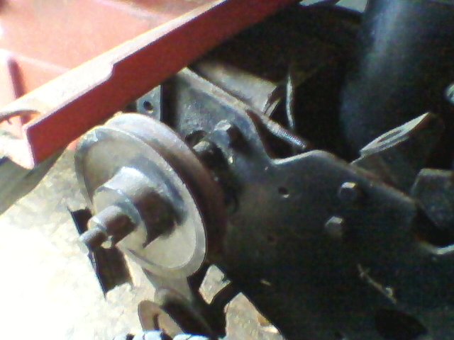

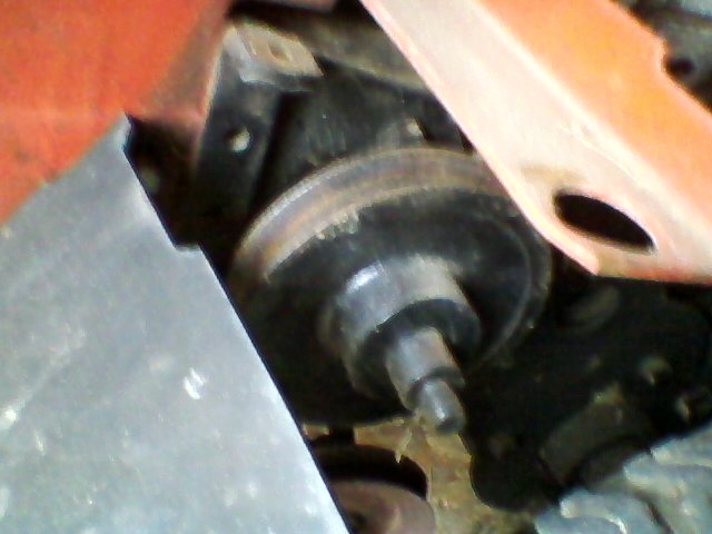

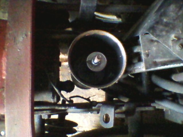

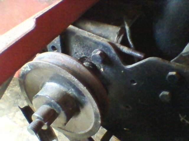

Okay larry,heres the pics u requested.As far as i can tell i already have the engagement lever,shaft,and safety switch so i just need everything else.Do i use dexron mercon 3 for the trans fluid,opened the reservior up and its bone dry lol
Posted - 01/11/2012 :  14:11:33  Show Profile  Visit larry8200's Homepage Send larry8200 a Private Message  Reply with Quote
Yup, I see what you need. You use Dexron III in the hydro, and Gear Oil in the bGB and axle. Is the hydro working like that? Awfull low.
