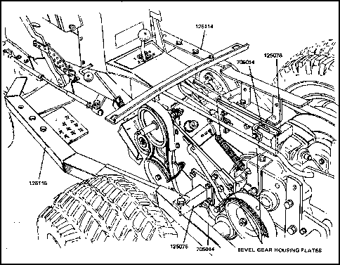

okay now i have hope i can make a nice looking and working loader how bout some pictures of the bottom where its mounted,thanks nick
joe fess
261 Posts
Posted - 11/02/2011 :  09:36:15  Show Profile Send joe fess a Private Message  Reply with Quote
Here are pict.of frame components I made. Michael has posted many pictures of Simp. loaders in past,ask him for link. Make a mirror image of long member for other side.
