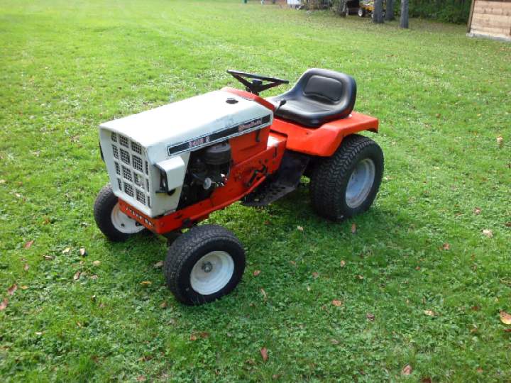

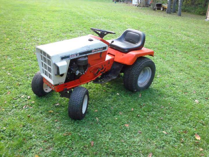

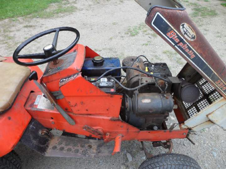

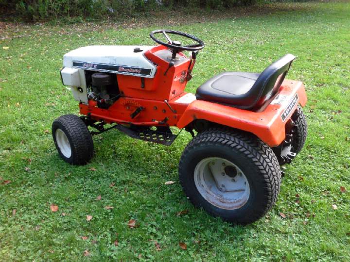

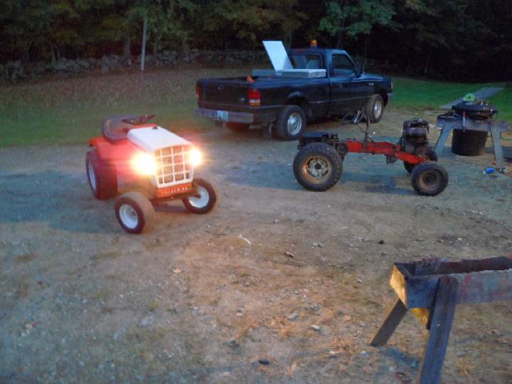

Got this in August, about as funky as they come. The wireing was the worst and had to be scrapped. I did like that 4 gauge battery cable connecting the little LT battery though. Fortunately I had a donor 3410S with a bad shuttle that donated Hood, Battery, Gas Tank, Front wheels, Wireing Harness and Battery cables, dash, ignition switch, fuel line/shutoff, seat, and 3 working headlights. Runs/drives about perfect now and its only problem is being a 3314H the only powered attachment I have that will work on it is the tiller off my B210, and it still has the "W" pulley on the center PTO for the mower. BUT, on the bright side it runs a FDT sickle bar. on the dark side, the engine has the syncro gears on the front and I can't put the mechanical PTO that I wanted there. Oh well, problems, problems....

Cleaned up pretty well. I need the shuttle transmission.
Posted - 09/29/2011 :  09:10:19  Show Profile  Visit larry8200's Homepage Send larry8200 a Private Message  Reply with Quote

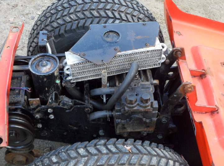

I have everything but the planetary reverser, despite cleaning and repacking it, it really whines. My guess is rebuilding it would be an expensive proposition.
I have another shuttle I may parts, just because the engine by its self is worth more than the complete tractor. Amd I'm doing some serious consolidatig before any further "collecting"
It would be to costly to ship a whole rear end, but aside from the 4 spa. transaxle its self, could probably do any of the rest. Dont know if I have a good planetary brake band or the neutral dampener without looking and counting though.
