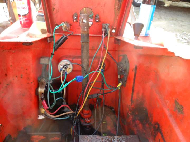

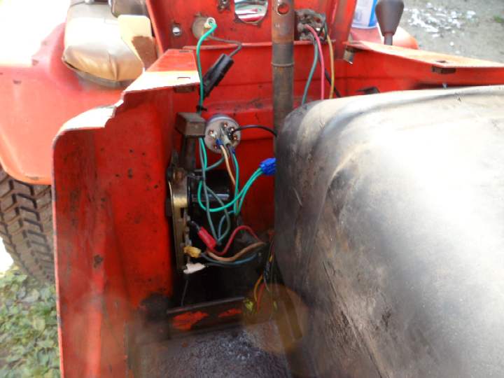

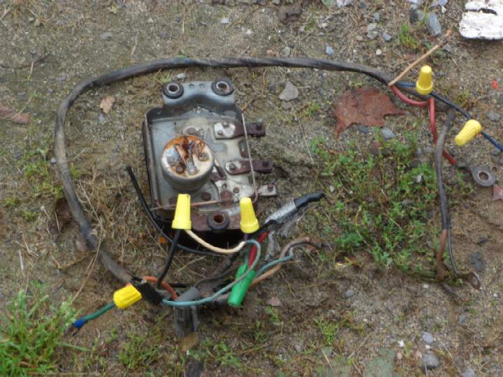

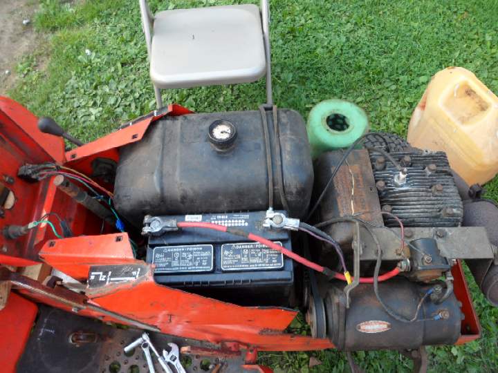

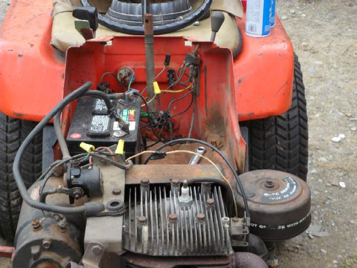

Posted - 09/26/2011 :  05:38:42  Show Profile  Visit larry8200's Homepage Send larry8200 a Private Message  Reply with Quote
This was about as hacked as I've seen and still worked, you cant see it in the pictures but the ignition switch plug was cut off and the wires stripped and jammed through the holes on the switches spade connectors. Amazing it worked. Had to take the tank out to put a new line in and could hardly leave this mess. I liked the 4 gauge battery cables hooked to a little LT battery. Fortunately I had some good parts to put it back together. :)

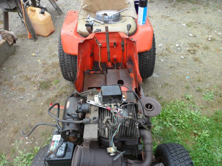

Posted - 09/26/2011 :  06:33:19  Show Profile  Visit larry8200's Homepage Send larry8200 a Private Message  Reply with Quote
This was easy, There is a 3410S with a bad planetary reverser I'm partsing right next to it and all the parts including the battery came off it. More than half the wireing here is for the optional lights and electric lift, without them it would be almost identical to a key start FDT. This has an idiot light instead of an ammeter.
