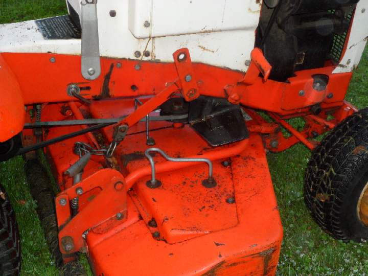

The cross drive belt on this 3212H is longer but otherwise the 42" deck/tractor setup is identical. Here are a couple of pictures:

Here is a B112 with the 48" deck.
I believe the manual calls for a 45" belt, but this is a 46" belt. I tried a 45" and it put the drive pulleys over top of the deck even more, and limited the ability to raise the deck.
Edited by - 10X on 09/21/2011 19:53:43
