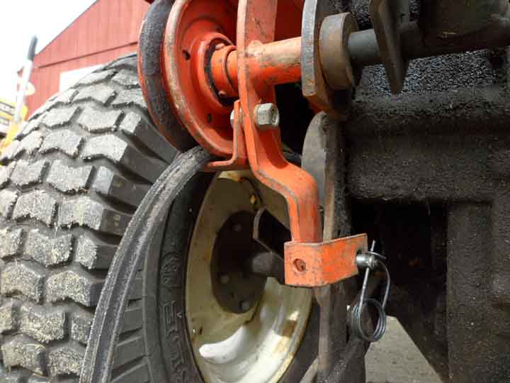

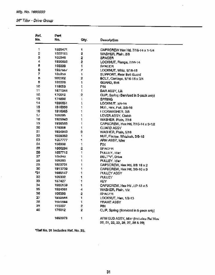

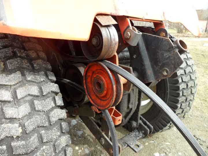

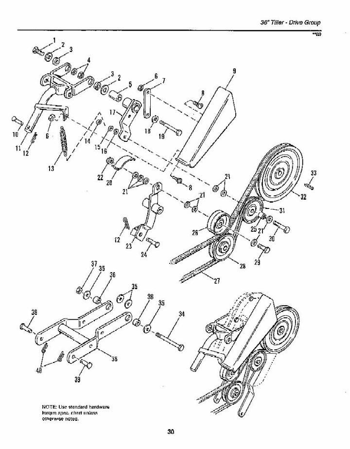

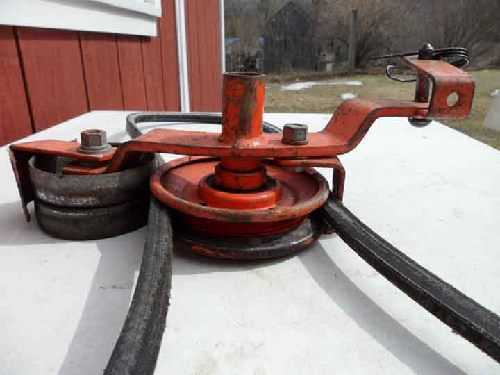

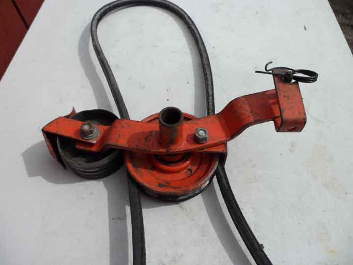

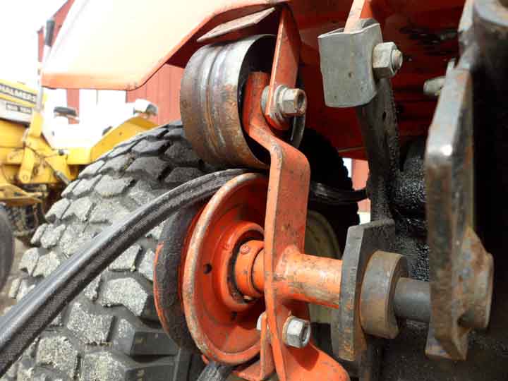

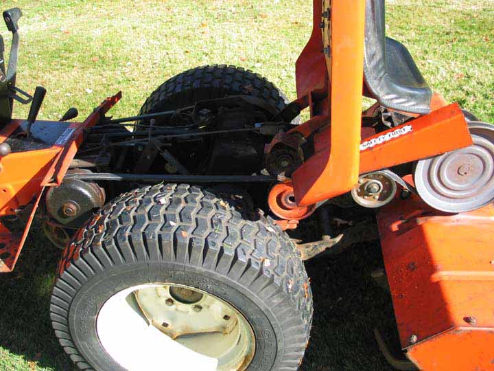

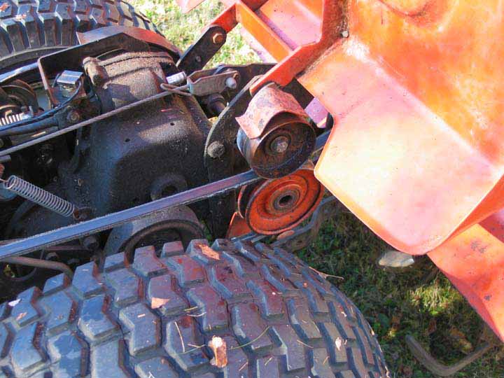

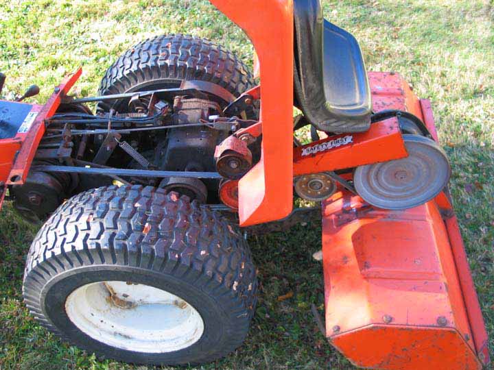

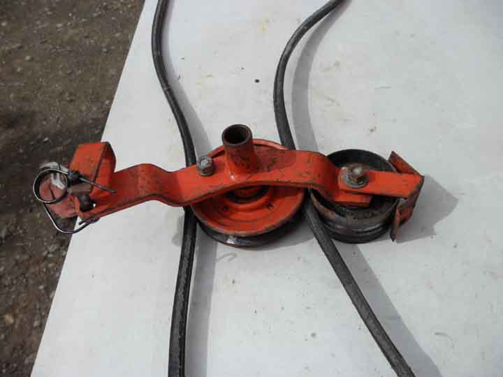

Was asked for belt guide info.
If I was missing the belt guide assembly I would buy part's 23, 26, 27 and 28 from Simplicity. (parts diagram at end) I cant see the pulley's coming from anywhere else and they are going to be more than the bracket anyway... Sandy Lake Implement is good source if no local dealer.

I bought 26, 27 & 28 from TSC. 23 is the tough one to find. Is that still available from dealers? They fetch anywhere from $40-$110+ on ebay. Important to note that they apply to FDT's as well as RBT's.

if you8 cant find them anywhere i looked last night and partstree.com has them it looks exactly the same as the diagram above
Posted - 04/13/2011 :  12:25:09  Show Profile  Visit Talntedmrgreen's Homepage Send Talntedmrgreen a Private Message  Reply with Quote
Hmmm...I looked this morning and their site said 'unavilable'. Are you talking about part #2105322, or do they have an alternate P/N?

T...I made one last fall, and it was extremely difficult to get the tension correct. I since, picked up a braket from ebay, added the pulleys from TSC, and that tiller runs smooth as butter...you won't regret it.
