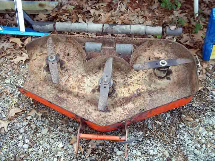

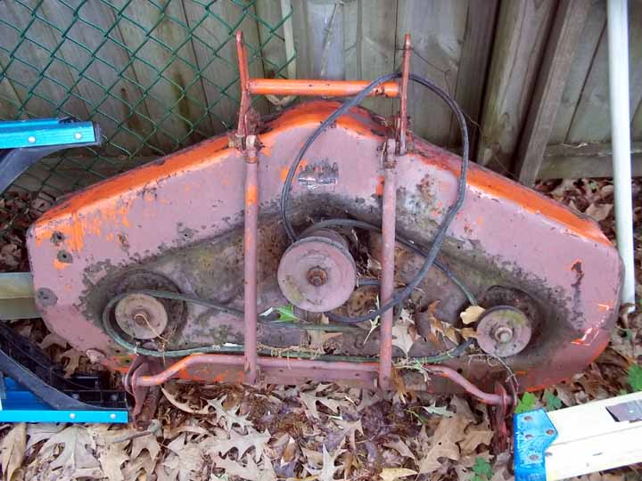

 Which mower is this ?
Posted - 03/31/2011 :  18:12:28  Show Profile Send skunkhome a Private Message  Reply with Quote
It has a tag but the numbers are obliterated.
Killer_A-C
20 Posts
Posted - 03/31/2011 :  19:47:22  Show Profile  Visit Killer_A-C's Homepage Send Killer_A-C a Private Message  Reply with Quote
Looks to me like a 900 series A-C 42" deck.
Posted - 03/31/2011 :  22:24:13  Show Profile Send skunkhome a Private Message  Reply with Quote
I'm sorry the tag does identify it as a Simplicity.
midnightpumpkin
888 Posts
Posted - 03/31/2011 :  22:36:58  Show Profile Send midnightpumpkin a Private Message  Reply with Quote
Phil,
It looks like it has the adjusters set wide apart to fit a RBT, that would narrow it down somewhat.
John U
Posted - 03/31/2011 :  23:16:14  Show Profile Send skunkhome a Private Message  Reply with Quote
I know it is a late model 1690XXX because of the bail setup and single bolt blade hubs.
Posted - 04/01/2011 :  16:06:51  Show Profile Send acdad a Private Message  Reply with Quote
It looks to me like its a deck that might fit a 1960's to 1980's AC or Simplicity garden tractor?
Posted - 04/03/2011 :  08:54:49  Show Profile Send ByronC a Private Message  Reply with Quote
Looks just like my 716's deck except I have a 48".
Posted - 04/03/2011 :  11:54:29  Show Profile  Visit simplelife's Homepage Send simplelife a Private Message  Reply with Quote

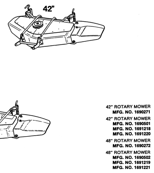

Can't say for sure which one, but it has to be one of these 42" decks. They are all covered under the same manual
Posted - 04/03/2011 :  14:50:19  Show Profile Send skunkhome a Private Message  Reply with Quote
Mike, that narrows it down. I had figured it must be the 1690501 because it has the straight blades if they are original . Wanted to see if anyone concurred.
