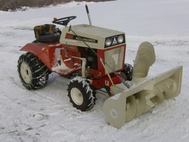

I have been looking for a snowblower for my 300/400 tractors for many years, I foud this one this fall about 20 miles from the house. This baby is like brand new with the original belts (I think). I used it for the firt time this week-end with good results. I can't believe how much faster it is than a plow......

a good blower is better then getting plowed.

Dan, that is one mean looking machine. very nice! I wish I could use a snowblower but with my rocky drive I would be throwing rocks like a shotgun!

Nice score on the thrower.
Here is the manual for it.

That is nice looking!! great find!

gearhead19, nice find on the blower, congrats and enjoy.

Hey Gearhead19, that is a very good looking tractor and blower you have there,I would like to know what size of front tires and wheels you have there? I would like to put that type of tire on the front of my AC 416s. Any information will be greatly appreciated thank you.

Great find on that Blower gearhead. It does look brand new.

Thanks for all the comments guys! Ryan what a great idea, I will be duplicating the wheel set-up on mine next summer. Oldsarge I will be making a spout rotator for it as well, did you use a r.h, or l.h side window motor? Dodgeman My front ag tires are 16x6.5x8 I will pm you the E-bay store wheni find it.. Mack thanks for the download link....
