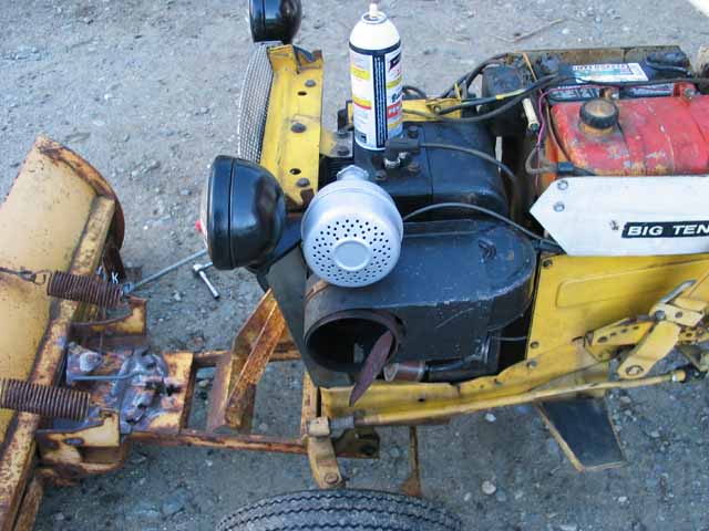

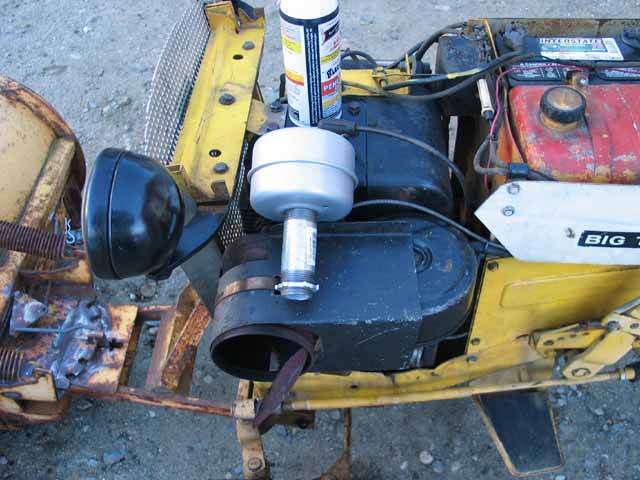

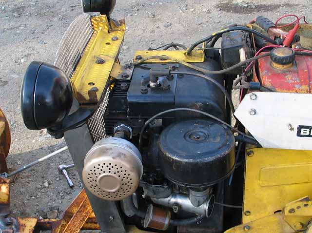

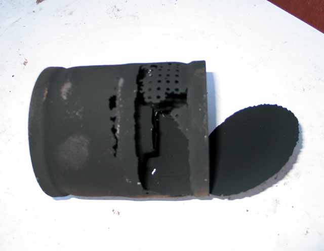

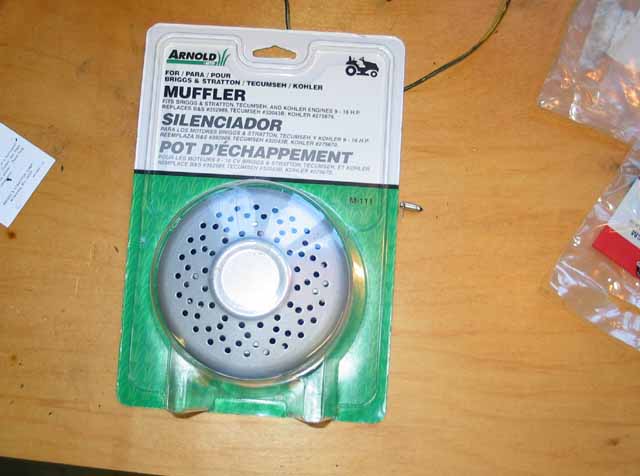

The old muffler's life just couldn't be stretched out any longer. The OEM from Simplicity was about $62.00 plus S&H special order. I found this one at Tractor Supply Company for $7.49, the pipe for $1.80, and the jam nut for $0.52. And it works fine with the factory heat sheild. It's quiet enough, and I'm not sure if that Nelson "Can" muffler was the right one for it anyway.
Here is the description and the B&S part #'s it replaces, as well as the web page.
SKU Number: 4440846
Manufacturers Number: M 111
•Large "Pancake Type" thread-on muffler
•1-1/4 in. O.D.; 1 in. pipe
•For 9-16 HP engines
•Replaces Briggs & Stratton® 299477, 392989 and 393232
•Replaces Kohler: 275679
•Replaces Tecumseh: 32043B
http://www.tractorsupply.com/outdoor-power-equipment/mowers-attachments-accessories-parts/mower-parts/other-mower-parts/arnold-reg-muffler-9-16-hp-engines-4440846

Larry I would be interested in how quiet that muffler is. I have one that looks just like it but is very noisy. Being new to these tractors I don't what a quiet one is. Also what is the shield around the muffler for? Alan
Posted - 01/08/2011 :  07:42:41  Show Profile  Visit 1014211's Homepage Send 1014211 a Private Message  Reply with Quote
I believe the shield is to keep heat from the exhaust around the carb to prevent ice over, yes? You would remove for warm weather use.
Posted - 01/08/2011 :  07:43:23  Show Profile  Visit larry8200's Homepage Send larry8200 a Private Message  Reply with Quote
Uhmmm.... It is reasonably quiet compared to the old one, which was really nothing more than a straight pipe anymore.
The shield is the OEM winter carb shield to to keep the carb warm
