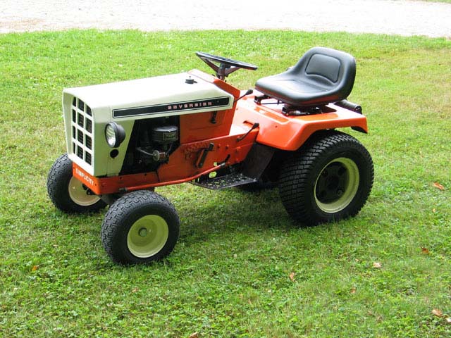

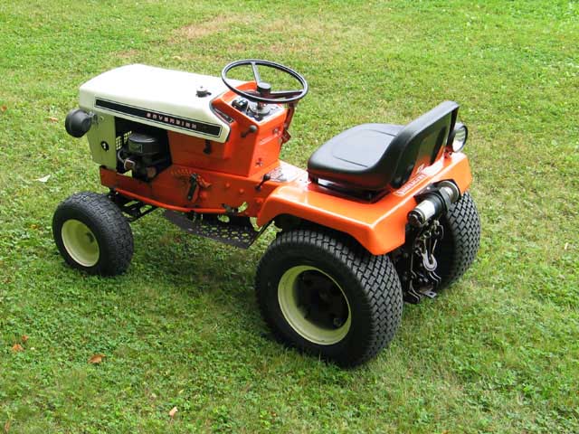

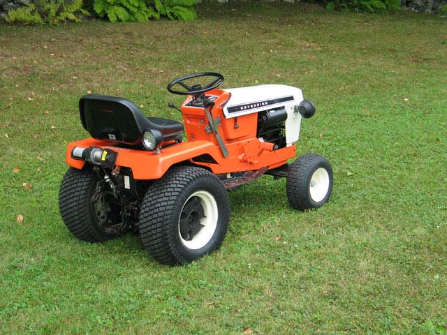

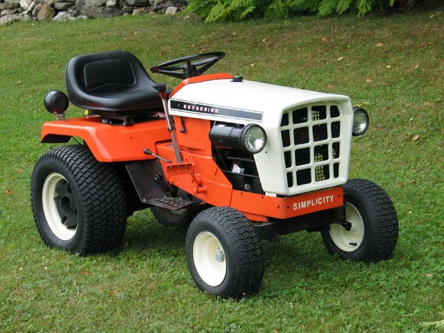

Posted - 08/22/2010 :  12:28:06  Show Profile  Visit larry8200's Homepage Send larry8200 a Private Message  Reply with Quote
Completely rebuilt front end (Tires, ball joints X 2, bushings X 4, Spacers X 3, spindles and tie rod from 92 GTH-L)
Re-worked and beefed up electrical system: Fuses, lots of wire, "new" S/G, Voltmeter, and Hour/Tach meter.
New center PTO complete, (well, nice used set).
New Seat.
Except rear rims, all new paint.
All new decals.
Replaced last two original belts.
AND most IMPORTANT: E3.10 plug conversion. :)
It's going to outlive me yet!

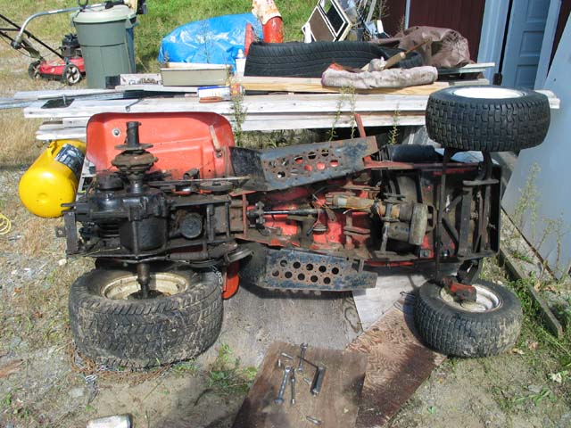

There isn't really any "before" picture anymore, I just keep improving it as I can, but not all the pictures are pretty either. This from September 2008:
It had sat for 9 months with (I thought) a blown BGB, but was in fact a loose set screw and missing key on the BGB's front coupler.
I had a serious stroke that spring, and after a summer of not being able to walk, the whole place looked like this picture. The doctors said I was unlikely to walk unassisted again, but although I still walk like I've had a few stiff ones when tired, I've been walking short distances unassisted since September of 2008.
