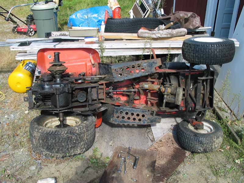

Hi, Fall of 2008 and she'd sat all summer. Was clearing snow the previous March when everything in the back quit. I'd thoght it was the BGB but turned out to be a loose set screw on the coupler on the front of the BGB. The keyway in the coupler wore until the key fell out. With the electric lift I could only tell the drive shaft was turning, but not the output shaft of the BGB. As much a pain as it was, it was a good thing, of the 2 lower bolts through the frame to the BGB 1 was missing and the other was loose. But all's well that ends well! Last picture for balance, and the trailer is an imposter.
