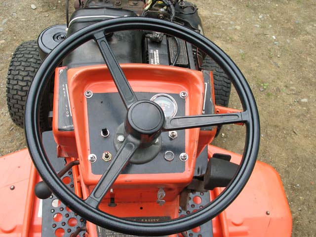

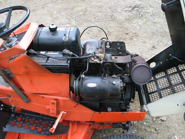

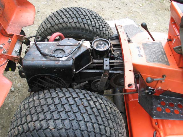

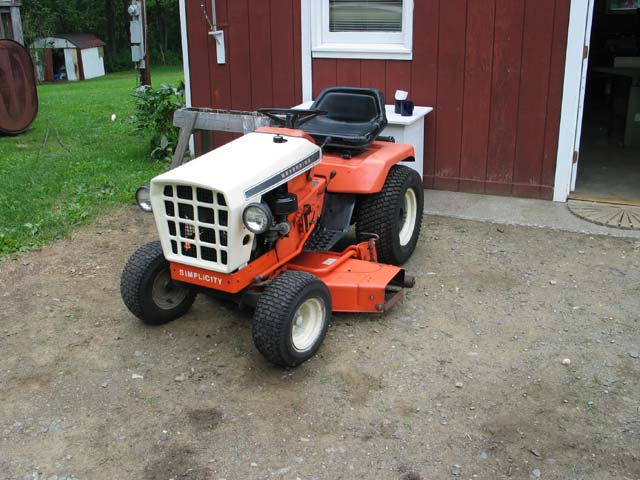

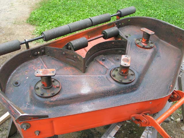

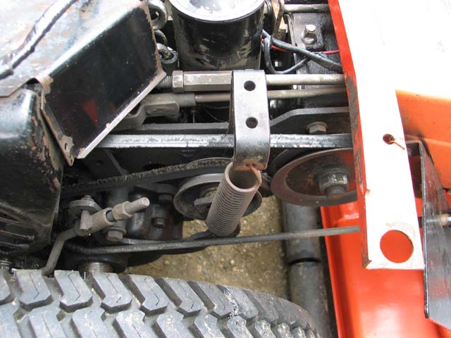

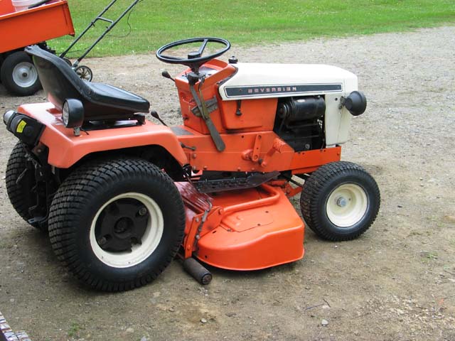

How many words are 20 pictures worth? More than I have at the moment. Anyway, someone said Post them pics!!!
These are from the last week playing with my 74 3416H

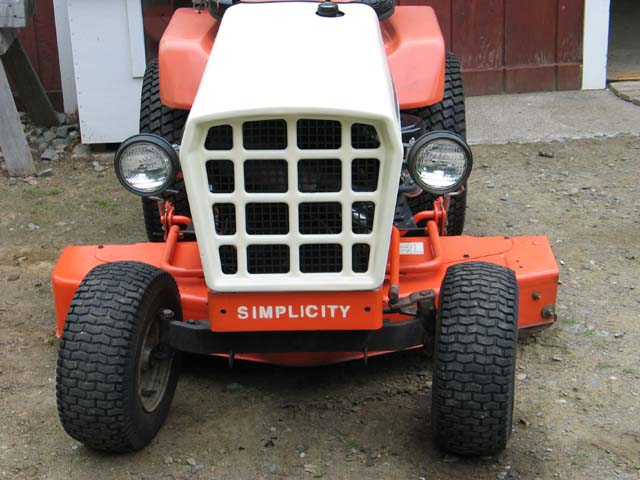

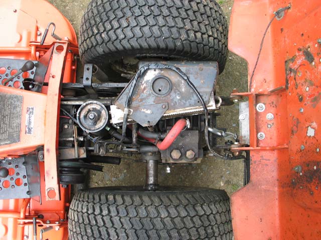

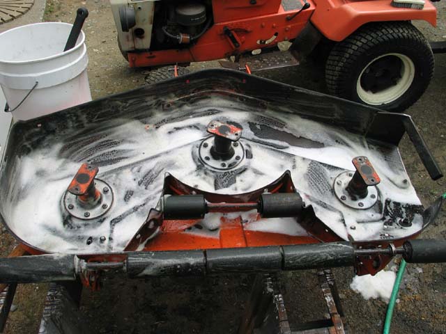

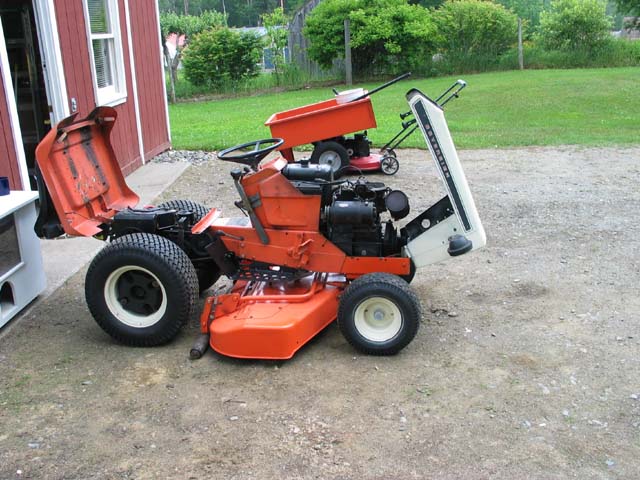

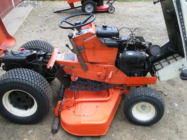

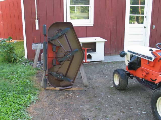

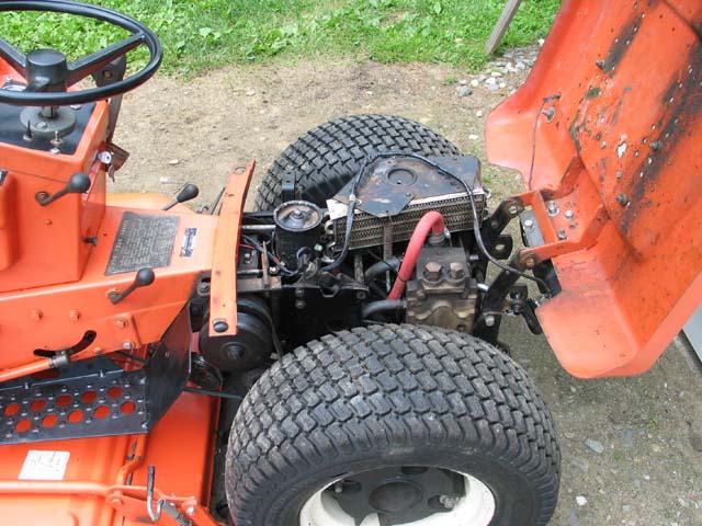

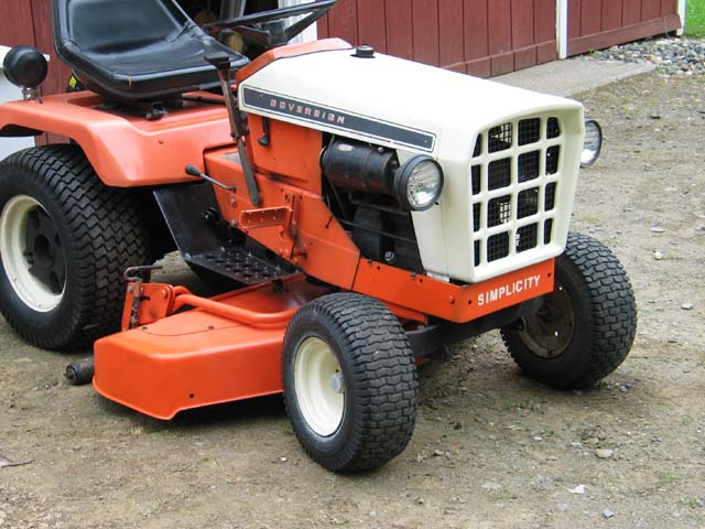

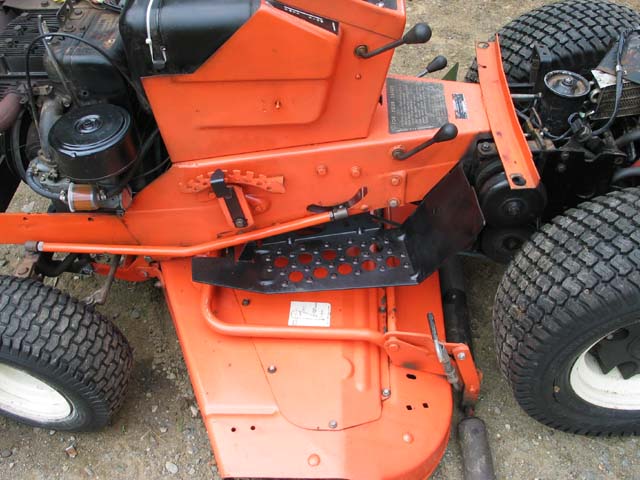

Tuesday morning went to replace the rear ball joint on the draglink. I couldn't get enough leverage with the deck on so had to take that off. I got the draglink off fine but the rear joint was stuck but good. Put it in a vice and heated the link nice cherry red. The joint came out screaming all the way. Now I had a draglink with half the paint burnrd off, so I sanded it down and repainyed it. While the paint was drying I figured I migh as well scrape some crud off the bottom of the deck. Got a little carried away... Hood decals original, made a "SIMPLICITY" stencil for front. Belt on hydro pump original (and has looked moth eaten for 20 years)

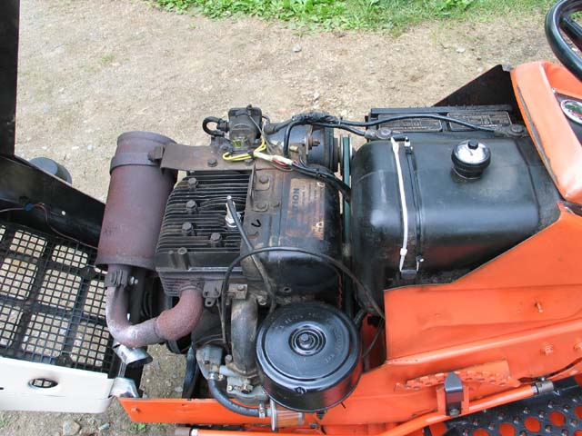

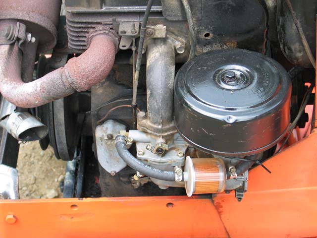

Notes: Look at hood on tractor behind soaped up deck. Since this tractor was new, the exhaust always hit inside the hood completely missing the hole, and the muffler has always been tight against the grill, made it tough to keep the hood nice. Made a little diverter (finally) to get the exhaust to go through hole. Brown paint on deck is Dupont Imron III left over from years ago and still good. Shoe Leather brown Did a lot of little stuff and a lot of paint.

Well that sure turned out nice! Cleaned the old beast up quite nicely.
Posted - 06/27/2010 :  21:44:14  Show Profile Send Cvans a Private Message  Reply with Quote
I for one like your headlights much better than the originals. I have had couple of the 3400 series tractors and they are one of my all time favorites. I would much rather mow with one of them than the 7117H that I have now. The 3400's steer much easier and turn tighter. I do believe the 7117 will be better with the snowblower. You have a nice tractor and I wish it were parked in my yard. Thanks for the photos's

Larry. You stated that you have the capability to heat things up. That muffler doesn't look like too big of a job to remove and give a slight twist so it aligns with the hole in the hood. Just my opinion but personally I would take a Sunday afternoon and do the job. Looks to be only a two or three beer mod.Also as to AC garden tractors in New england; I got my 620 out of Cummingtom Mass. B10Dave

Was looking at the exhaust again this afternoon. Still causing problems I think. 3 beers sounds like an affordable fix to me!
