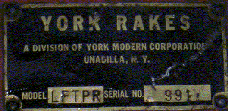

I'm looking for ideas on where to get parts for a York Power Rake from 1982. This is the plate:

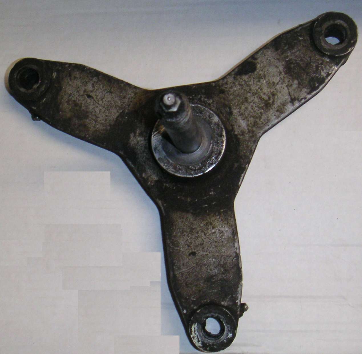

This is the rake being disassembled:
I called York and they don't have the manual, nor do they have any more parts besides the tines for the rake. They advised they were unfortunate to have a flood and they don't have any manuals from those times either.

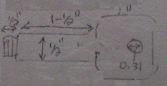

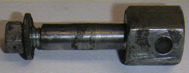

I'm looking to find a replacement "shaft bolt"... Is that the correct name? If you needed one of these how'd you make it or get it fabricated? I'm thinking you'd buy some hex stock mount it in a lathe, grind out the middle of the stock. Cut it in half. Probably drill the holes first to make sure those cut correct. Then cut threads on the shaft. Not my cup of tea, but interested how'd it would be done... or who might do this type of work. Or better... can this type of part be bought?
Sketch1 - Shaft is 1.5" long diameter 1/2" with a 1/2" - 3/8" thread.

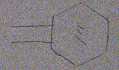

Sketch2 - The bolt size is about 1" high and fits in a 1" socket. It has a hole approximately 0.31" which bolts into a U-Bolt.

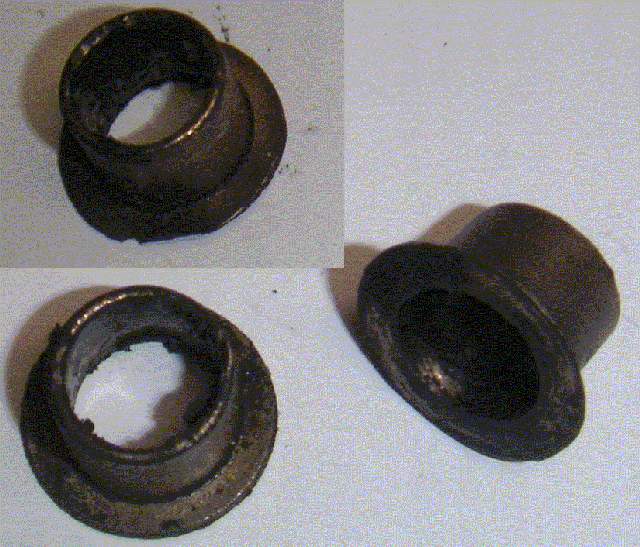

Bronze Bushing - I'm still looking for a good replacement, will probably wait until I can find a shaft bolt.

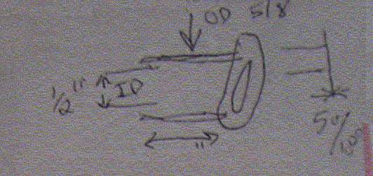

Sketch3: (Bushing sizes 5/8"OD x 1/2"ID x 1/2"L thickness 50/1000)

Michael first off you need to know if the bolt is hard or not? then is the threads right hand or left hand? Any machine shop or anybody with a lathe can make that in a short time. Alan

Michael, send me a piece of hex,,,and I'd be glad to make one for you. You would either need to send the old one,, or give the location of the hole. Hex would need to be about 3" to long,,,for chucking.

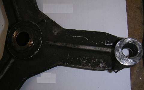

Here's some parts I need to center these holes and size up bushings:
Could this be done with a standard drill press or do I want to have this machined? I'd figure I should get new bushings fitted in these before I fabricate the other shaft bolts. Should I be looking for any particular hardness of metals?

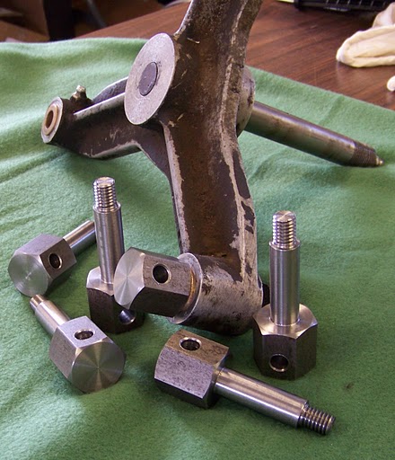

Posted - 05/22/2010 :  17:04:05  Show Profile  Visit Denny's Homepage Send Denny a Private Message  Reply with Quote
Something like this ??

Posted - 05/22/2010 :  19:59:59  Show Profile  Visit B112's Homepage Send B112 a Private Message  Reply with Quote
Like exactly! Wow nice job! When I get this machine back together, I'll get some videos.
