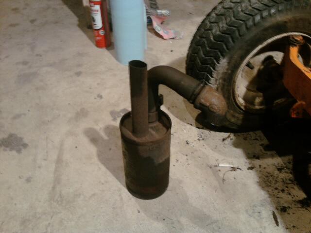

so i went to start her up today and i had to put the charger on it and once started i let her warm up good and took her around the house by the garden and she died.. i checked and a wire going from the wires up by the key (not sure what one) that leads to the solenoide was almost melted. it was speaker wire and so i replaced the burnt part and i had to run the extension cord out there with the charger to start her it was a pain on the BUTT! it was overheated so much i think i opned the hood and there was a thin smoke came out and the heat waves were amazing it was deffinatly overheating. i think it was the exhaust due to the huge hole in it
so i just want a whole new wireing harness (if possible) and muffler.

now for the exhaust i finally got it off.. and well it litterly fell in two.. it was rotted straight through..it took me a while to get the rusted bolts off. anyone have an exhaust for me? i can pay

Posted - 02/22/2010 :  21:33:42  Show Profile  Visit storm7016's Homepage Send storm7016 a Private Message  Reply with Quote
Pay shipping and its yours.
But I did have to cut it off, so it will take some work.

Posted - 02/23/2010 :  05:44:22  Show Profile  Visit storm7016's Homepage Send storm7016 a Private Message  Reply with Quote
http://cgi.ebay.com/Simplicity-1-Diameter-Exhaust-Pipe-Elbow-7016-Briggs_W0QQitemZ170450195050QQcmdZViewItemQQptZLH_DefaultDomain_0?hash=item27af9f926a

Posted - 02/23/2010 :  17:28:47  Show Profile  Visit 3414HDuval's Homepage Send 3414HDuval a Private Message  Reply with Quote
STORM!!!
your a life saver!
message me with your address and or phone number so i can call you and we can work something out!!!!
god that put me is such a good mood!!!!
