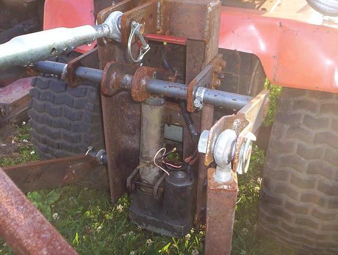

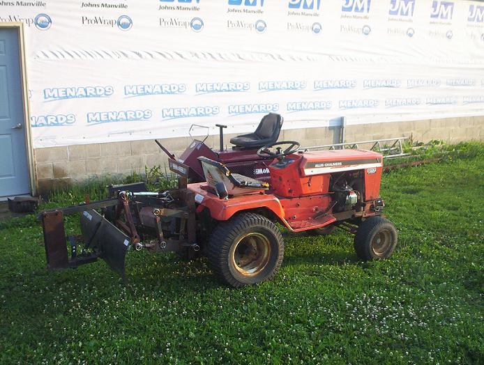

Heres the electric 3 point hitch I made using the deck lift actuater. Deck was rotten and didnt need lift so I made a 3 point with it, added car alternator to run it and moved brake to left and made the hydro a foot pedal. Works good but with no float feature not good for grading.
