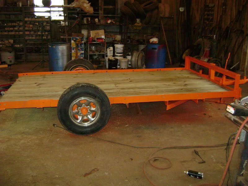

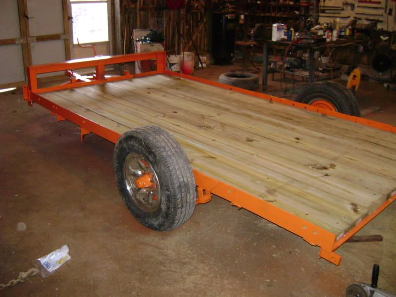

I am kinda aggravated with myself for not taking "before" pics to show how bent & mistreated this trailer was when I got it. It started as a 16' with tandem house trailer axles & wheels. The rearmost 4' of frame was bent to crap from the people driving a 12K dozer on the thing. They had welded crap all over trying to beef it up.
So I cut the back 4' off, and most of the extra metal they had welded on. The trailer axles came off and I used the front axle hangers for the 5,200lb 6" drop-axle w/springs I already had. Re-welded many of the joints & added metal where needed. The heavy head-ache bar was already on it when I got it, glad it was in place.
The main frame is 3x4" angle iron that measures a tad over 1/4" thick. I know the axle is back a tad further than most, but I wanted it that way to be sure not to ever have negative tongue weight. I'll be pulling with a HD F250 truck, so it can handle the weight. Right now empty, I'd guess tongue weight at about 230+ pounds.
I just put the floor down & bolted in place this morning. All 2x10 treated. I have to pick up a set of lug nuts as I have just enough to hold wheels on at the moment.
I will build a full width tailgate later on when time allows. May add fenders too. It will be 2 piece to make for easier lifting. Now I'll have a trailer for most any need. I have a 9x6, this one, then a 16' tandem. The tandem is the "farm's", so I wanted a heavier trailer for myself as we have the 16' tied up with loads a lot.
And I bet ya notice the color paint too!!!
