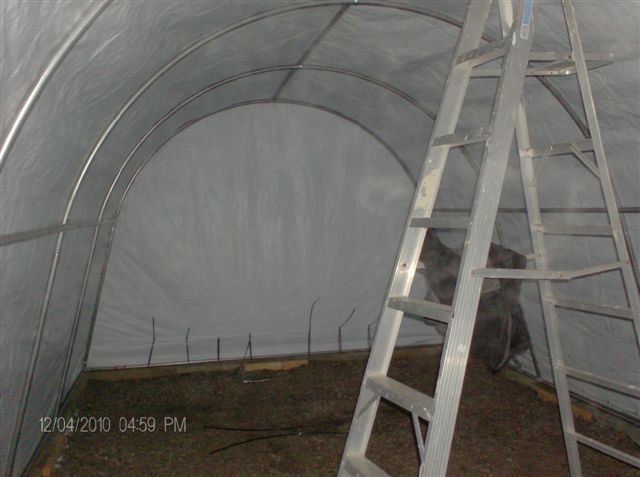

BRAD1975 Posted - 12/14/2010 : 21:18:29
It must be pretty dark in there?..or does the fabric has some translucency to it?

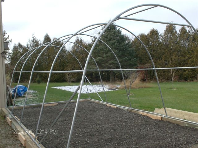

B10Dave Posted - 12/04/2010 : 21:57:54
Picked up my portable garage on Thurs. Spent today putting it together. Only thing left to do is rent a plate tamper to compact the recycled asphalt.
Frame is all assembled and screwed together. Next two pics show cover on but not tensioned. Last pic shows nearly completed interior.
Did the whole project witout any help. Gave me a great sense of accomplishment. B10Dave

B10Dave Posted - 11/21/2010 : 17:29:05
Michael. The anchors are already in place. See second last pic. I built the brackets to bolt to the timbers and drove the angle irons 30 in. into my gravel driveway. With the angle irons at the pitch they are it provides fore and aft support and the timbers cannot be pulled straight up either. Also the 8x8 timbers weigh approximatly 100 lbs. each so I don't think anything will be moving. There is an anchor bracket lagged to each timber. Dave
