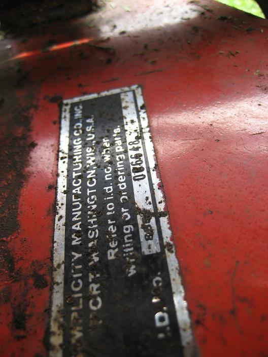

Posted - 05/25/2013 :  22:22:34  Show Profile Send Cvans a Private Message  Reply with Quote

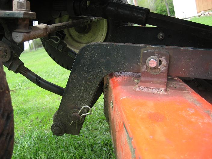

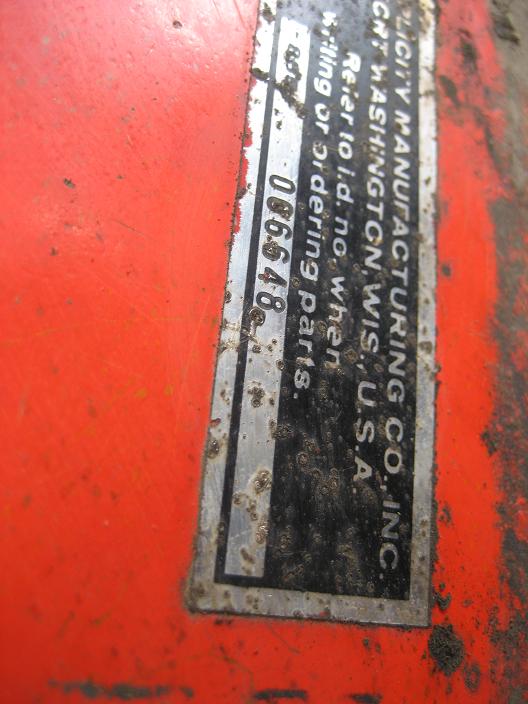

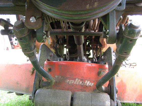

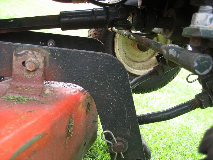

Mowed today so I snapped some photos for you. Maybe you can glean enough info from the tag to tell which deck it is.

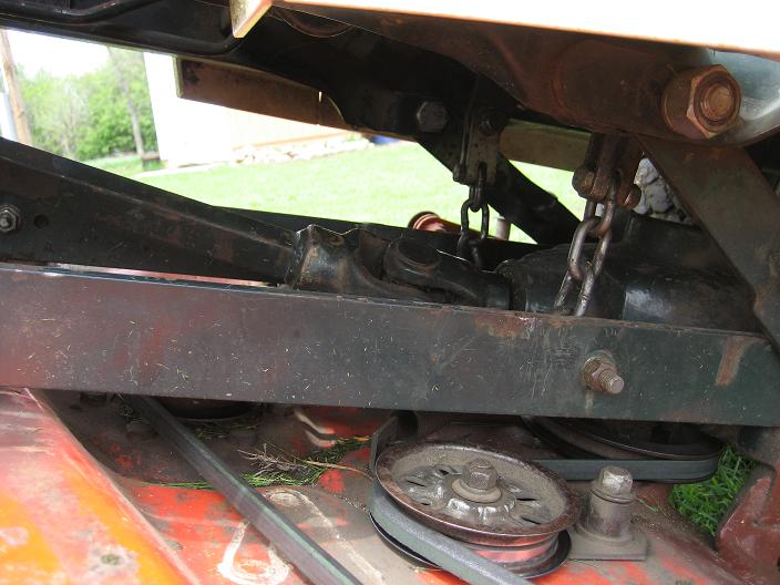

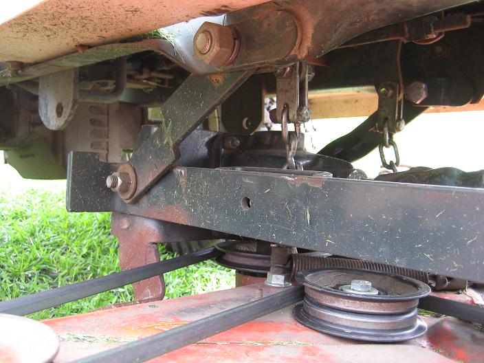

As you can see in the photo below the blade drive belt had to completely rerouted to incorporate the gearbox.

Hope this helps. Again, great job on the conversion!
http://bsintek.basco.com/BriggsDocumentDisplay/heCBEN8arL0rE3Cvh5kbp796Dq.pdf
Posted - 05/26/2013 :  10:15:23  Show Profile Send skunkhome a Private Message  Reply with Quote
Yes that is a 990885 which was the first mower they made specifically to fit the RBT's That is the same mower that was on my 3414 and the donner of the arbors and rollers to my "new" mower deck that Biggie Rat so graciously gave me.
BTW, I think you did a super job on the conversion.
So it is shaft drive to the mower than a belt runs the deck arbors. That is a great way to isolate the tractor drivetrain from the mower shock. I support the pto is belt driven through the front axle pivot.
You picked a top notch mower.

Wes, thanks for the information. That did help.

Yes it is belt from the engine to the PTO shaft. Then shaft to the gear box which is mounted on the deck support frame. Then from the gearbox is a belt to the blade arbors. Routing the blade belt without rubbing on anything was a head scratcher.
