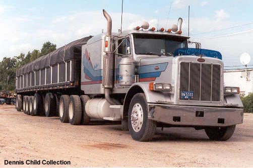

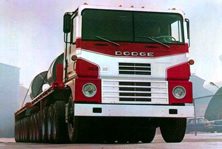

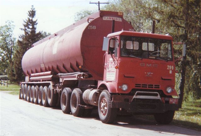

Phil; they steer Ok for the number of axles. As you can see in Michaels pics link, 5 of the 8 axles are liftable. All 5 could also be self steering when down and under load. The truck I drive has only one lift axle and it must be up to turn at intersections etc. Some have the steerable lift axle and it only needs to come up when reversing. I drove one of these three trucks ago and the third axle lifted automatically when trans was put in reverse. Idiot proof!!!
Michael; I have also seen eight axle flat decks in Mich. hauling steel.
Here are some pics of Michigan trucks. As you can see Mich. has had 8 axle trailers since the sixties. The Dodge cabover is from around 1967. It is a two trailer combination with a tandem dolly for second 5th wheel. Loaded unit has 50 tires on the road....Dave

What's in there liquid lead?? It doesn't look too much longer than a normal tanker. Might be bigger diameter. Most drop axles they run around here are steerable. Id say those would have to be at 100k. Dont see more than 3 drops or 16 wheels total, mostly coal haulers around here.
