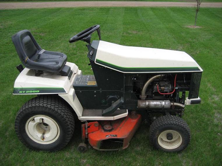

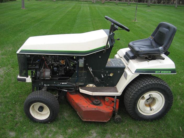

One of last winters projects was to convert a Bolens GT2000 to diesel and have it mow like a Simplicity. Seems to have worked out. Now for a new seat and paint the deck. I sure like those stripes.

Nice work Chris! Was that a left hand discharge deck originally?
superbinder
214 Posts
Posted - 05/18/2013 :  21:10:13  Show Profile Send superbinder a Private Message  Reply with Quote
Looks good, how are you driving the deck?
Posted - 05/18/2013 :  21:24:07  Show Profile  Visit olcowhand's Homepage Send olcowhand a Private Message  Reply with Quote
What size Yanmar?
Posted - 05/18/2013 :  21:33:23  Show Profile Send Cvans a Private Message  Reply with Quote
Yes it was a lefty. Adapting the deck turned out to be kind of a fiasco. It is now driven by the Bolens gearbox so the rotation was backwards. Took the blades from the Bolens deck and shortened them to fit the Simplicity deck. After that was done the grass would not exit the discharge chute so that had to be closed and another opened on the other side. All the grass comes out the upper front corner and heads behind me at a 45 deg. angle. Fans out nicely and doesn't leave clumps. To tell the truth I had my doubts that it was going to work. I guess a guy has to get lucky once in a while.\
The engine is a Yanmar two cylinder 13hp. out of a semi truck tri-pac. I think they are called APU's. Seems to have plenty of power.

Nice looking conversion on the mower deck. Does it have rollers in the back?
Posted - 05/19/2013 :  08:59:27  Show Profile Send Cvans a Private Message  Reply with Quote
Yes it does have the rollers and they seem to be doing their job. I can mow along the edge of the road ditch and not scalp the ground. I would have preferred to use one of Simplicity's deeper decks but there just isn't room under the tractor with the gear box.

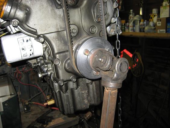

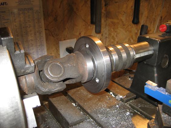

The original 20hp. Kohler that was in the tractor used an electric clutch for the PTO. I was not able to use that and now use a cable operated manual clutch. You can see the handle in he second photo above the brake. This is also a Simplicity item. The drive shaft is attached to the engine via an adapter that I machined for that purpose.
